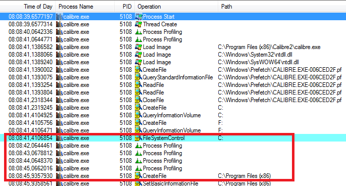

By accident I had monitored a relatively long delay on starting-up calibre, but mind this was not an actual freeze. Calibre seems to query some disk info which somehow takes seconds to complete.
On normal startup it just takes microseconds.
Kovid's question is a good one: do you have any mapped network drives? If so, are they to resources that are not on line?
Do you have any "drive-like" devices plugged in?
Do you have any real-time backup program running?
