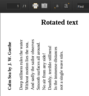

I may have to venture out into the world of SVG - of which I've remained blissfully ignorant so far.
Actually, you only need a couple of SVG commands to rotate text, however, you'd need to hard-code the position of each line.
On the plus side the embedded SVG file will work with ADE 1.7 (or higher), iBooks and Kindle KF8.
