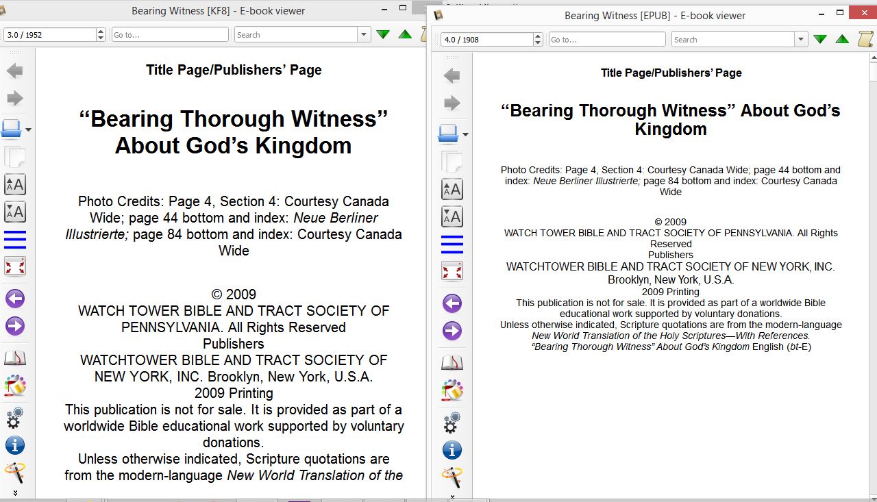

The problem is when I convert from EPUB to AZW3, the font is too big.
AFAIK, Calibre doesn't change font sizes when converting from epub to AZW3, unless you've defined a custom stylesheet to be added during conversion. (Just because the text in the AZW3 file looks larger in the Calibre book viewer it doesn't necessarily mean it'll look larger on your Kindle also.)
If the text in the converted AZW3 file is also larger on your Kindle, the epub designer most likely used fixed font sizes, which the Calibre book viewer and other apps might ignore.
However, without seeing the original epub styles and the converted AZW3 styles it's really hard to tell what's causing the problem.
If you want to play detective right-click an ebook that you've converted to the AZW3 format in Calibre and select Edit book from the context menu. (This will open Calibre Editor.)
Enable the Live CSS option in the View menu and click a random paragraph. This should display some Live CSS style information in the lower right corner.
Take a screen capture, edit the converted AZW3 file, click the same paragraph and take another screenshot of the style information.
Old 06-13-2015, 06:34 PM   #8
maurices5000
maurices5000 began at the beginning.
Posts: 71
Device: Kindle Voyage
Thanks for your help.
[You've been a member here long enough to know that it is a courtesy to wrap something this long in spoiler tags. -- MODERATOR]
The original is using relative font sizes.
The styles are definitely different. There are 9 style sheets in the original EPUB. In the AZW there are only 3. Many of these rules are duplicated for some reason in the 9 files.
However, the concern is that the values are different.

Just from this one tag, you can see that the font family is changed. The sizes were rounded, etc. The important indicator is completely ignored.

Notice the difference in this set of rules
Original:
<p class="st"><b>“Bearing Thorough Witness” About God’s Kingdom</b></p>
p.st, .document .ct {
font-family: "Arial", Helvetica, sans-serif !important;
font-size: 1.25em;
text-align: center;
line-height: 1.1em;
margin-top: 0.5em;
margin-right: 0em;
margin-bottom: 1.5em;
margin-left: 0em;
-webkit-hyphens:none;
The AZW file:
<p class="st2"><a class="pcalibre1 pcalibre2 pcalibre pcalibre3 calibre5" id="page3"></a><b class="calibre4">“Bearing Thorough Witness” About God’s Kingdom</b></p>
.st2 {
-webkit-hyphens: none;
display: block;
font-family: "Arial", Helvetica, sans-serif;
font-size: 1.29032em;
line-height: 1.2;
orphans: 2;
text-align: center;
widows: 2;
margin: 0.36em 0 1em
The other styles don't seem to have a direct impact on the font-size in the AWZ they are just margins, bold, color etc.

It looks like the font sizes were indeed changed in the AZW3 files. Theoretically this shouldn't happen unless you've added an additional CSS file or CSS rules in Calibre. Select Preferences > Common Options > Look & Feel and make sure that no CSS file paths or CSS rules are shown under Extra CSS.
If Extra CSS is empty, try converting your ePubs with Kindle Previewer/KindleGen, split it with the Calibre KindleUnpack plugin in Mobi7 and AZW3 components and have a look at the AZW3 file. If the KindleGen generated styles look more or less OK, you may want to ask a moderator to move this whole thread to the Calibre Conversion forum, because you might have found a rare Calibre bug that only Kovid Goyal can help you with.
EDIT: I converted the original file myself and can confirm that Calibre does indeed change the paragraph font size from 16px in the original file to 20px in the converted AZW3 file. A KindleGen generated AZW3 file doesn't have this issue. There appears to be a bug in the AZW3 converter.

Have you tried Disable font size rescaling? This is the top checkbox in the Look and Feel tab.
