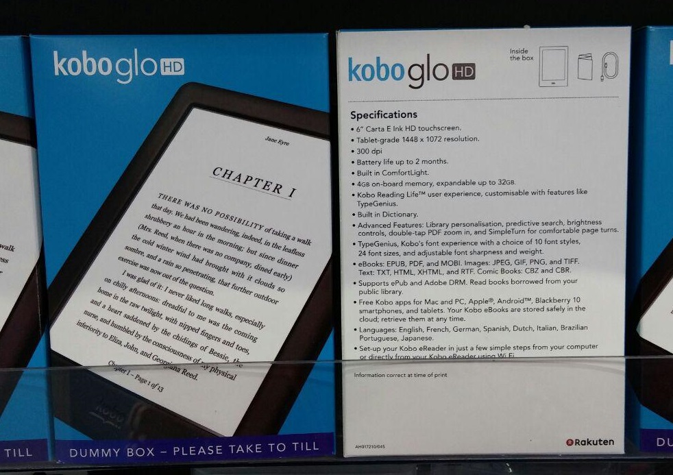

hi guys.
was out at WHSmith today (UK stationary shop) and saw the kobo glow hd. it's awesome and i'm buying one at the weekend. anyway i took a pic of the box since everywhere even the kobo website says no expandable storage but it says it is upto 32gb on the box.
