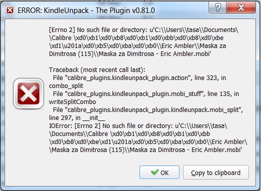

I got an error with new version of KindleUnpack and new 64 bit clibre v2.28

What happens when you try the other functions (unpack, extract epub, etc...) on that title.. Is it only the Split function where you get that error for that book, or all of the functions?
Old 05-17-2015, 10:17 AM   #322
DiapDealer
DiapDealer's Avatar
Posts: 28,922
Karma: 207182180
Found it!
That unicode path bug has been lurking in the plugin's Splitter function (on the Windows platform) for a long time. Hard to believe no one's run into (or reported it) yet. Thanks for finding it.
I'll test the fix to be sure, but I should be able to upload a fixed version later today.
Thanks again for the report.

Sorry for late reply - thank you for a plugin. it is real life savior. But i only use split function...
Works fine now..
It worked fine till calibre v2.28 ...
Thanks for fixing it!

To be fair, though ... calibre was entirely blameless (as was the underlying KindleUnpack engine). The problem was the jump from v0.77.x of the plugin to 0.80.x. Version 0.80.x introduced an entirely new codebase (both engine and plugin). I did something goofy when trying to hook into the underlying Splitting function that was blowing up whenever a calibre library and/or file path containing non-asciii characters was passed to the wrapper method.
