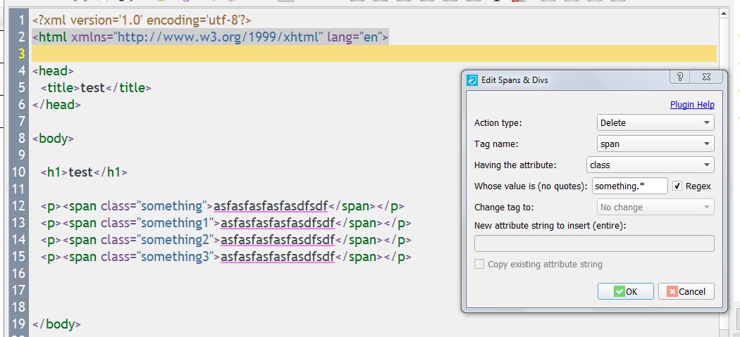

I really like DiapDealer's plug in
https://www.mobileread.com/forums/sho...d.php?t=251365
You might look into it since I think it might handle even complex cases like that
