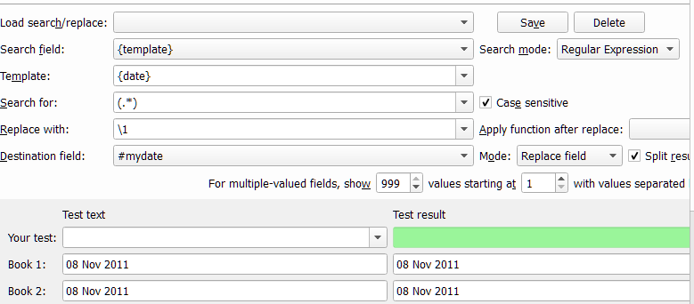

Add a custom column (Preferences / Add your own columns / the + icon) with type "Date". Name the column something like lookup name "#added_date" and column heading "Added Date".
Once you have the column you need to copy the date column to your new custom column. This is done with edit metadata (multiple) Select all your books, press E, choose Search/Replace, then fill out the form as shown in this screen capture. I suggest that you back up your library first. Once this is finished then you must manually maintain the new date.

Sorry, just noticed that I didn't include the screen capture for the search/replace. Here it is.
