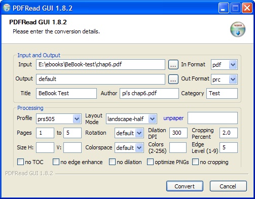

It's OK, I don't need your .pdf; I'll just show you using a sample .pdf from caritas' pi thread.
Below you will find two .prc ebooks (first 5 pages only and in landscape-half mode). One was created using the prc-mobi profile; the other using the psr505 profile. Both used .prc as the Out Format. (see the picture below)
See if there is any difference/preference; experiment if you need something better.
p.s. I zipped the .html and images used to make the 'chap6_prs505_profile.prc' and attach it below as well.

Old 12-21-2008, 06:11 AM   #161
Giangio
Giangio began at the beginning.
Posts: 7
Device: Bebook
Cool Good result but..
I've tryed them and the only one I see rightly it's the prc-mobi profile, the other one has problem with edges and doesnt go to next page and if I try my bebook crashes!
With prc-mobi there is a problem(but..it's a problem?): the pagecount isnt right! For example, It's starts form 1 of 6, when it arrives at 6, I push next and then it change in 6 of 7 an go on....there is some other thing to set in the program?
Another question: I suppose that to see in the pdf rightly the only way it's on portrait but...I'll prefer to see it vertically and not horizontally but I suppose isnt possible...isnt it?

Old 12-21-2008, 08:14 AM   #162
nrapallo
GuteBook/Mobi2IMP Creator
nrapallo's Avatar
Posts: 2,958
Karma: 2530691
Location: Toronto, Canada
That tells me that the BeBook screen size for displaying images (like the PDFRead pages) is then better matched with the prc-mobi profile.
For Layout Mode 'landscape-half ', each .pdf page is split into two page turms with Right Rotation. It takes two page flips for every "page" and has the TOC (table of contents) as page 1. The ebook contains 7 pages and BeBook should show those page references properly. If not, then that may be a firmware issue.
Sure it's possible, that's what the portrait profiles do (i.e. prc-mobi-p). The only problem is that for a 6" screen device it is VERY hard to read .pdf pages as images as the text is too small. When you read in landscape mode, then the page can be visually "increased" and that results in a bit larger text size. It's a trade-off: reading text size vs comfortable reading position!
