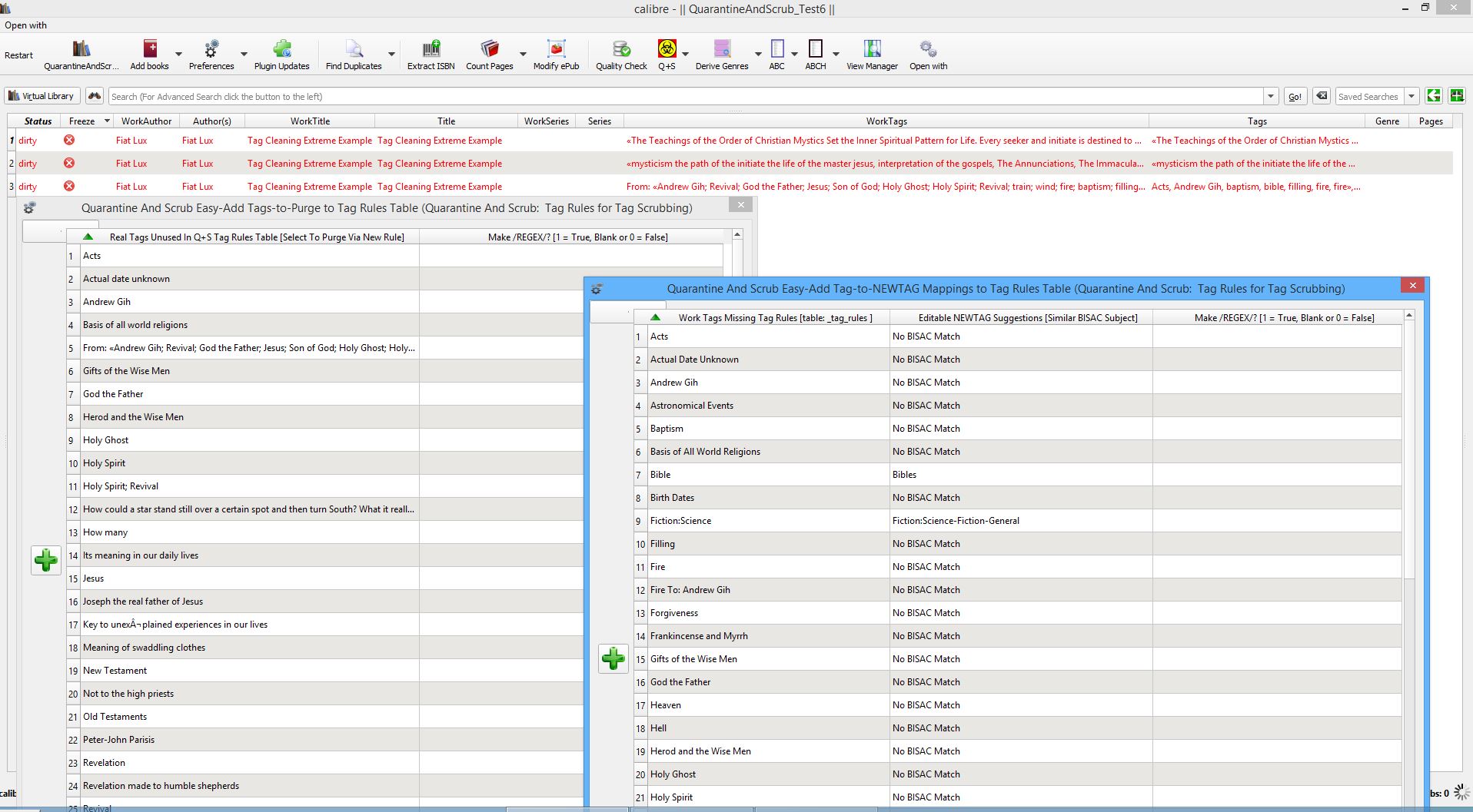

A) Can this extension change semi-colons in tags to commas, deleting duplicate tags in the process, without user intervention?
Example # 1:
From: «Andrew Gih; Revival; God the Father; Jesus; Son of God; Holy Ghost; Holy Spirit; Revival; train; wind; fire; baptism; filling; Bible; salvation; sin; forgiveness; hell; heaven; New Testament; Acts; Old Testaments; Revelation; School of Prayer; Peter-John Parisis, Son of God, heaven, Revival, salvation, New Testament, Acts, filling, Old Testaments, train, Revelation, forgiveness, Holy Ghost, baptism, Andrew Gih, hell, Holy Spirit, God the Father, Jesus, School of Prayer, sin, bible, Peter-John Parisis, wind, fire»
To: «Andrew Gih, Revival, God the Father,Jesus, Son of God, Holy Ghost,Holy Spirit; Revival, train, wind, fire, baptism, filling, Bible, salvation, sin,forgiveness, hell, heaven, New Testament, Acts, Old Testaments,Revelation, School of Prayer, Peter-John Parisis, Son of God, heaven, Revival, salvation, New Testament, Acts, filling, Old Testaments, train, Revelation, forgiveness, Holy Ghost, baptism, Andrew Gih, hell, Holy Spirit, God the Father, Jesus, School of Prayer, sin, bible, Peter-John Parisis, wind, fire»
B) Can this extension delete, clean up, or otherwise make sense of tags like the following?
Maybe an option to just delete everything here.
Example # 2: «mysticism the path of the initiate the life of the master jesus, interpretation of the gospels, The Annunciations, The Immaculate Conception, The Birth of the Christ, The Wise Men and the Star, the shephards and the sheep, The Manger and the Swaddling Clothes, the gifts of the wise men, Herod and the Wise Men, The Flight and Massacre, Twelve Years of Age, the baptism, the fast, the marriage feast in cana, the betrayal, the crucifixion, three days in the tomb, the resurrection, the ascension, astronomical events, symbolical interpretation, birth dates, inaccuracies and contradictions, The Universal Solar Myth; Basis of all world religions; The Annunciations; To Elizabeth and Zacharias; To Mary and Joseph; Why made by Gabriel; The Immaculate Conception; Why disputed for ages; Joseph the real father of Jesus;The Birth of the Christ; Actual date unknown; Why Dec 25th was chosen; Its meaning in our daily lives; The Wise Men and the Star; How could a star stand still over a certain spot and then turn South? What it really was; Who were the Wise Men;The Shepherds and the Sheep; Revelation made to humble shepherds; Not to the high priests;The Manger and the Swaddling Clothes; Why was Christ born in a stable; Meaning of swaddling clothes; Gifts of the Wise Men; Symbology of gold; frankincense and myrrh; Their meaning; Herod and the Wise Men; Key to unex¬plained experiences in our lives; The Flight and Massacre; Were any children actually slain; How many; Why denied by St Luke; Twelve Years of Age; Where was Jesus during His early years; Why 12 is an important age; The Baptism John; Why did Jesus, Basis of all world religions, The Shepherds and the Sheep, Their meaning, How many, To Mary and Joseph, Its meaning in our daily lives, Where was Jesus during His early years, Were any children actually slain, Revelation made to humble shepherds, Symbology of gold, frankincense and myrrh, Not to the high priests, Gifts of the Wise Men, Meaning of swaddling clothes, The Baptism John, Actual date unknown, Why did Jesus, Why denied by St Luke, Who were the Wise Men, Why was Christ born in a stable, Why disputed for ages, Why Dec 25th was chosen, Why made by Gabriel, Key to unex¬plained experiences in our lives, To Elizabeth and Zacharias, The Universal Solar Myth, How could a star stand still over a certain spot and then turn South? What it really was, Joseph the real father of Jesus, Why 12 is an important age»
C) Can it automatically remove tag(s) like the following:
Example # 3: «The Teachings of the Order of Christian Mystics Set the Inner Spiritual Pattern for Life. Every seeker and initiate is destined to walk the same well trodden path of those that have come before. There is but one universal story of the initiate. The One Pattern Life we are all in the process of unfolding. Based on the Life of the Master Jesus. The most astonishing yet revealing interpretation of the Gospel story. Gives it a new spiritual yet logical and scientific appeal. The result of Dr. Curtiss' 20 years of painstaking and scholarly research in the fields of comparative religion, philosophy, psychology and symbolism. The results are astonishing if not sensational in the religious field. Not dry scholastic argument, but applied to the daily experiences of our lives. Gives the only satisfactory explanation of the many inaccuracies and flat contradictions in the Gospels. Accepts the historical facts recently discovered, but definitely refutes the materialistic conclusions of the "higher critics" and mythologists. A great reconciler of conflicting opinions and theories. Will cause as many happily changed lives as any other of The Curtiss Books. Illustrated with a hitherto unpublished picture of the Master Jesus.»
I don't want to install this extension, and learn how to use it, if it isn't capable of that type of cleanup.
Why, o why does Google Books/Internet Archive/Project Gutenberg not stick to the library standard of three or four subject headings as tags in their books?

Extreme Tags
@Fiat_Lux:
Yes. See the attached.
Obviously it is up to you to specify what is garbage/trash/undesirable and hence should be immediately purged, and also to specify what each Work Tag that is not purged should be changed into via a Work Tag to a New Work Tag mapping rule. For each, the rule can be a simple 1:1, or can include an automatically created regular expression.
All of these rules remain in Q&S after you have moved your books to your "real" Calibre library after Q&S has finished with them. That is where the incomplete Fiction:Science mapping choice originated.
After scrubbing, a Work Tag Minimization function that uses Tag Priorities (that you define in the Tag Priorities Table ) will reduce the number of Work Tags to the maximum number that you also specify (in Customization).

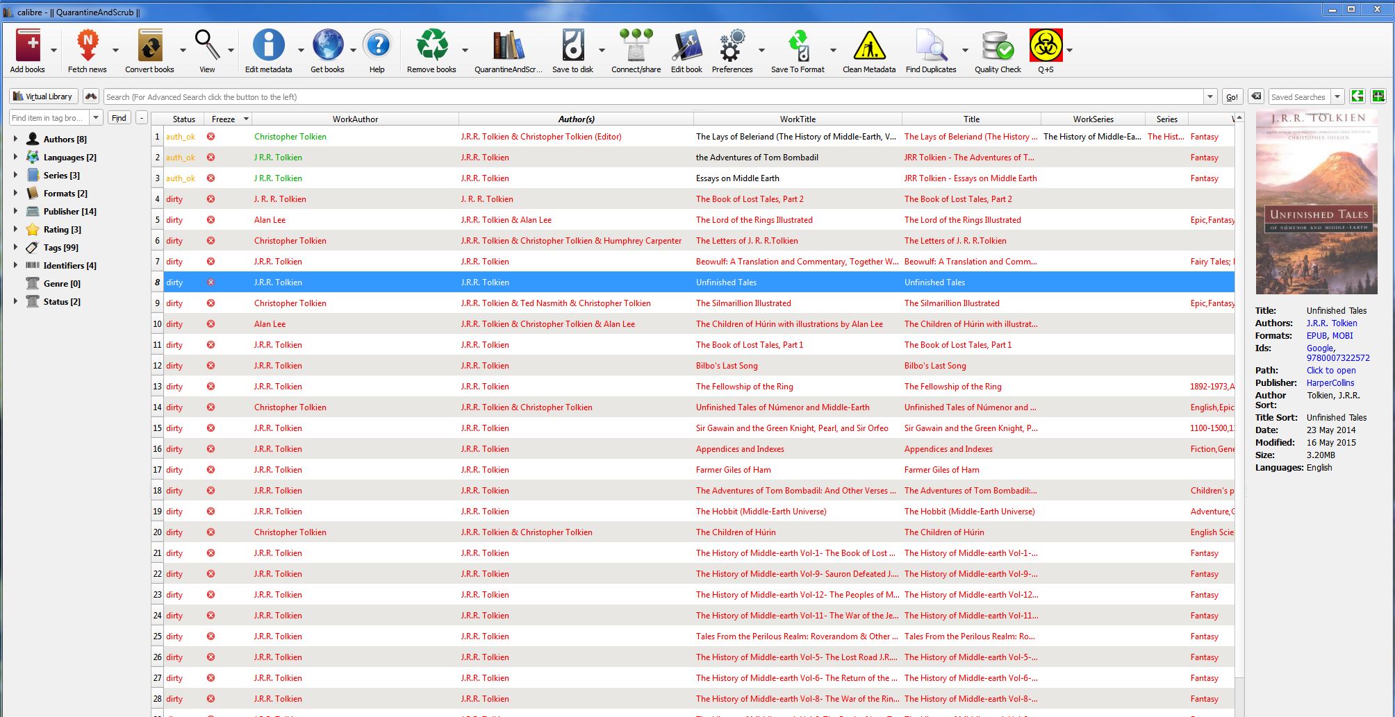

here's a screen shot after author scrub. Originally I had JRR Tolkien, then I searched and replaced in bulk metadata to J.R.R. Tolkien and I'm still getting all these dirtys.

Your screen print looks 100% correct to me. Please read the User Guide. It has the steps to follow. All you have done is to perform Author Level Scrubbing. Now, as the next step of many, you must run Book Level Scrubbing. "Dirty" means "ready for Scrubbing".

Thanks for reply -
I did read it, but maybe missed something. I started everything from scratch this morning. I was pretty sure, when reading, that it said - do the author scrub, the status should change to author_ok, then move on to title.
When I didn't see author okay for most of my records, but on a couple, I thought that might have been a problem.
step 8: 5) Scrub for Author at Author Level. The Status of changes will be set to “auth_ok”.
Like I Mentioned, I originally had those authors like: JRR Tolkien, after the author scrub it didn't make any changes to it, was expecting J.R.R. Tolkien.
(I know you clearly mentioned that 1) set author sort and 2) change initials to X.Y.)
that's why I changed prior to clearing out and recopying to J.R.R.
Anyway, why does it set a few entries to author_ok and most are left dirty? (even, as you say, they appear to be fine)
Thanks in advance, I'm gonna love this tool!!

@camelx:
The job log for Author Level Scrubbing (and indeed, all job logs in Q&S) explain what they did and why. Sometimes they also explain what they did not do and why they did not do it. They also provide helpful advice and other information when useful.
You must review each and every job log in Q&S to understand your results, preferably while the job is still running.
If you examine your top 3 books with a status of "auth_ok", you will see that their original titles had the Author name commingled with the real title. Author-Level Scrubbing removed the Author from the Work Title. None of the other books had that issue. The job log will have printed the Old Work Author, Old Work Title, New Work Author, and New Work Title as of the end of the job. Next, when you run Book Level Scrubbing for those books, it will pick up where the former job left off and complete the scrubbing of the New Work Author and New Work Title, as well as Work Series, Work Series Index, and Work Tags.
The very bottom of the Author Level Scrubbing job log also shows the total number of books that had a Work Author and/or Work Title changed. That count can be reconciled to the details of what was changed in the previous lines of the job log.
Only books that are changed by Author Level Scrubbing have their Status changed to "auth_ok". If it does not change anything, it does not change the Status. That is why the User Guide says: "The Status of changes will be set to “auth_ok”".
