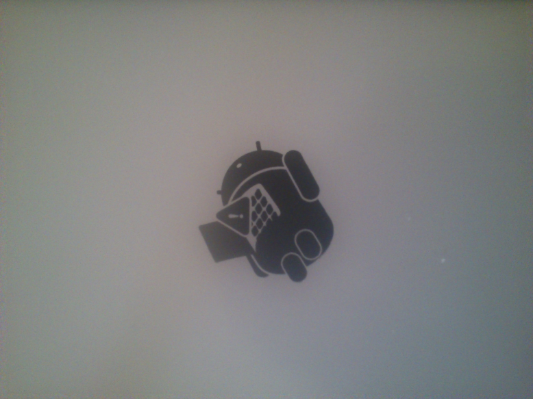

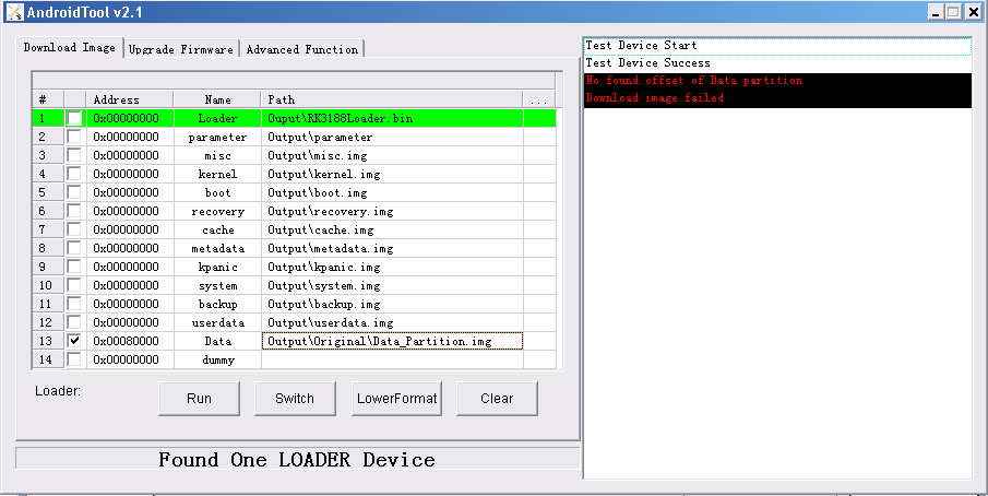

Constant Bootloop
I'm now in constant Bootloop.
I tried to solve this with the following:
1) I wanted to boot into recovery and got to the image of the robot lying down with open stomach:
"5.To get into recovery mode, press & hold the refresh button for 5-6 sec then press the power button for 2-3 sec and keep holding the refresh button for 2-3 sec"
But how to proceed from here? The device is not reacting to anything. (After some time it started the bootloop again.)
2) If I want a factory reset I probably have to clear the Data-partition.
I tried to overwrite using:
B) How to install IMG files OR (Restore your device's data) :
with my previously saved Data-partition but this is giving an error "No found offset of Data partition..."
3) Reflashed system partition - still bootloop
4) Wiping Data & Cache Partion via ADB
Tried:
adb wipe data
adb wipe cache partition
not working, wrong command
adb shell
su
wipe data (no permission to access data)
wipe cache (working still bootloop)
5) ADB reboot recovery
Robot with oben stomach, no access from usb, after some time bootloop started again.
6) Last straw (now used):
Firmware Upgrade via Rockchip Batch tool 1.7.
Accidentally pressed Restore instead of Upgrade but still seemed to Updgrade nicely. Now back to firmware V3 OTA Upgrade of V4 is offered. Still downloading.
Any ideas how how this could have been solved without fw-upgrade?

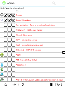

White on white.
Back from the Bootloop...
In which apps exactly you have problems and is it black on black or white on white?
Also could you perhaps backup your system partition as described in 1st post and send me a link so I can perhaps try to mod it to fix the issue?
For instance in AfWall:
Take a look at the last Apps which are nonSystemapps (White on White).
I will certainly make an backup of the system partition if you are really willing to help me out. Thanks for that offer.
