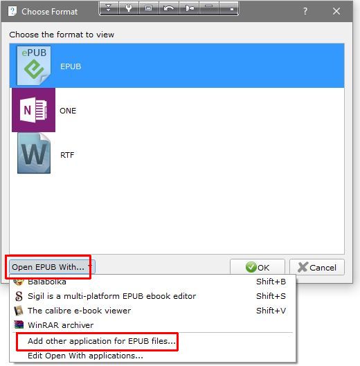

I have a question. I am using the Calibre program as administrator of my epubs, but I like Icecream Ebook Reader for reader. I set the plugin to open a epub with this program, so I configured to use Ebook Reader. However when I run the option "open with ...", Ebook reader shows me this message: "Failed to open database Unable to connect to database.". The program then runs normal, but don't shows the books that I added to the library. I close the program, open it again and quite normal. The funny thing is, that as I associated epub extension to Ebook Reader, if I click on any file epub, the program opens, there are still books added to the library and also charges the epub file I clicked. What you could be happening?

@mariaclaudia - this can be a 'tricky' issue, especially on Windows. If prior suggestions don't take you to where you want to go, then you may find the built-in Open With feature simpler to use than the Open With plug-in. You access it via View->View specific format (Alt/V) viz
To add another program to a particular file type, select the file type (e.g. EPUB) then select the Add other application for xxxx files option, that will open a standard file selection dialogue, browse to the required program, and tap OK.
If required you can then add keyboard shortcuts via Preferences->Keyboard, as I've done for Balabolka, Sigil, and the calibre viewer.
