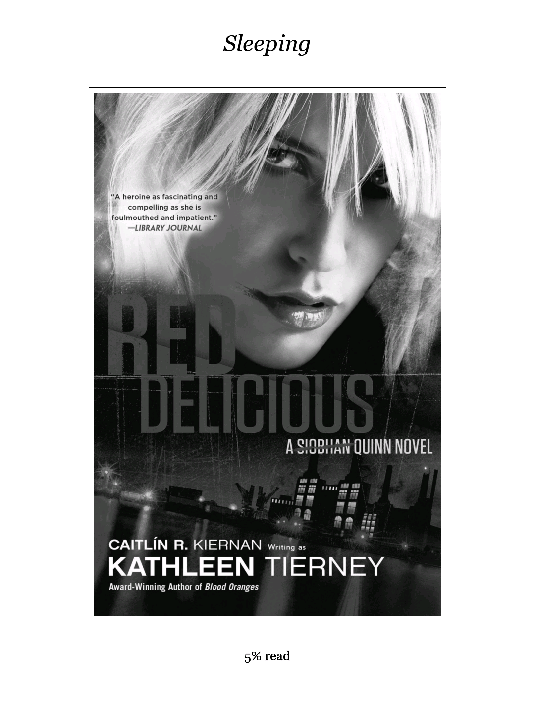

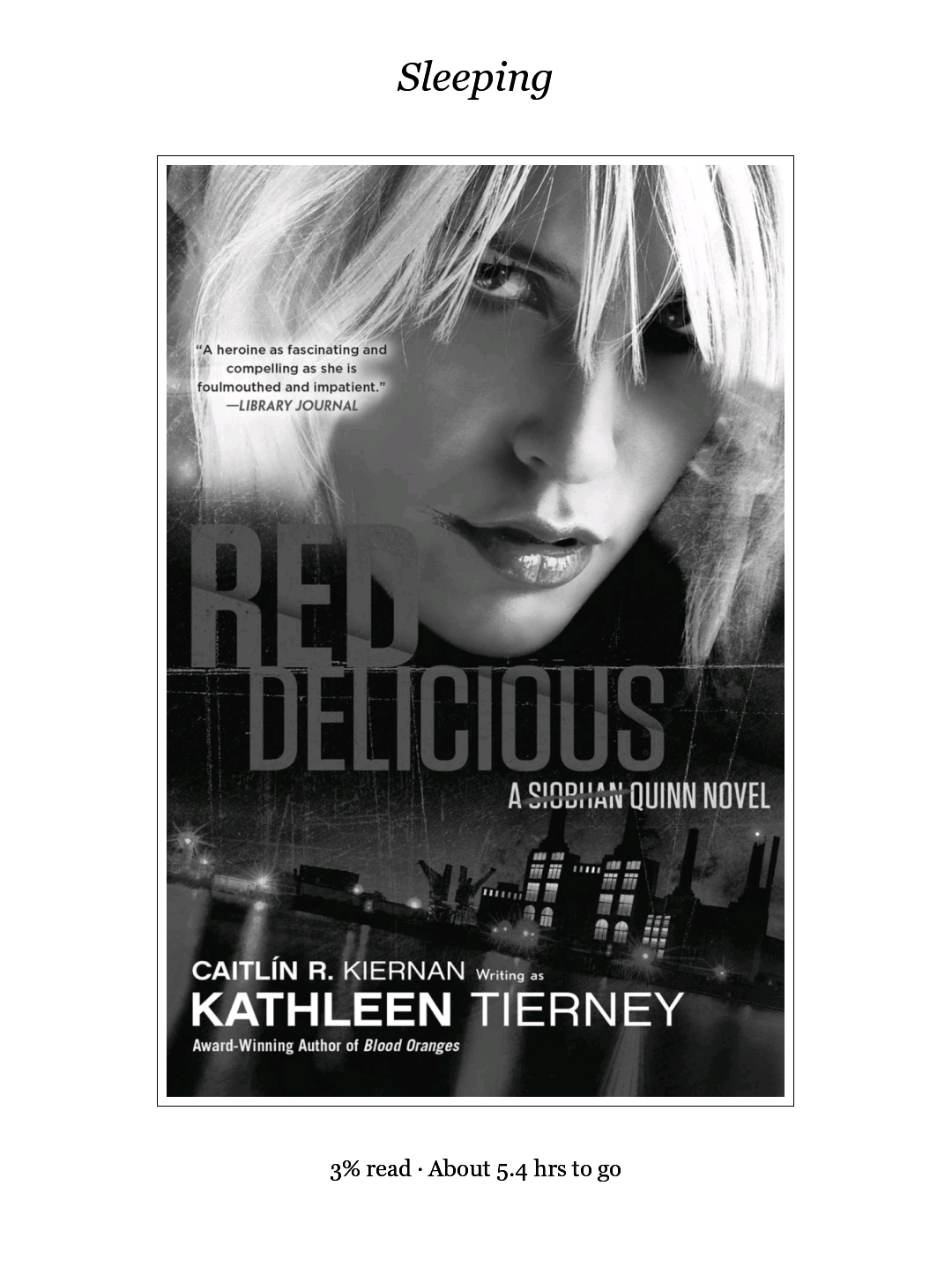

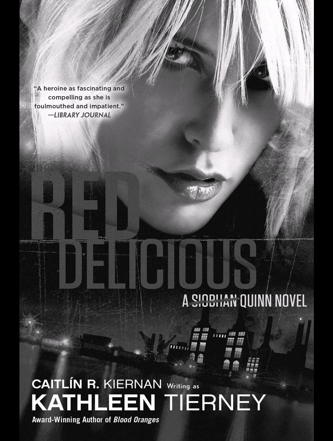

Okay, here's the set:
sync: straight from the Kobo store.
The pngs are fbgrabs from what's actually shown on screen when sleeping, with/without the fullscreen cover setting.
vanilla: vanilla Calibre 2.26.0 (OS X, binary release)
patched: patched Calibre 2.26.0 (Linux x86, fully source built)
patched_v2: patched Calibre 2.27.0, with the -v5 version of the patch, letterboxing disabled (Linux x86, fully source built)
Both Calibre instances have the exact same library (rsync'ed between the two boxes).
ID:	137663   Click image for larger version
ID:	137664   Click image for larger version
ID:	137665   Click image for larger version
ID:	137666   Click image for larger version
ID:	137667   Click image for larger version
ID:	137668   Click image for larger version
ID:	137669   Click image for larger version
ID:	137670   Click image for larger version
ID:	137841   Click image for larger version
ID:	137867   Click image for larger version
ID:	137868   Click image for larger version
