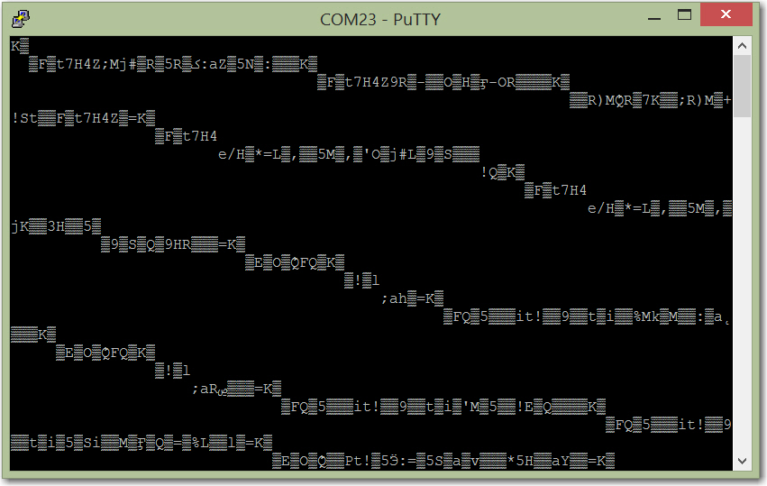

Anyone can help with this terminal Putty. It run when PW2 restart but can not read
hontehai is offline   Reply With Quote
What are you using for the adapter between your PC and the Kindle serial port?
What communications settings do you have selected in putty?

Baud rate 11500, 8bit, 2stop as previous thread. Only difference is I use windows 8. I do not have Linux PC. Dougle Profilic is used with Cisco serial without any problems. Very strange.
What is the LV Serial interface level of that device?
1v8, 2v2, 3v3, 5v0, other?
How did you connect it to the Kindle?
As in, lead by lead for each connection point.
PS: What do you mean by "previous thread?"
It's may be 3v3, but I do have the TTL splitter. Rx(center pin)/Tx Kindle to Tx(pin3)/Rx(pin2) RS232.
"previous thread" mean references from previous pages of this thread
The image you posted is something called: "ground noise" -
Connect the ground lead of the adapter to the ground of the Kindle.
Already connect from pin5 to GND of Kindle.
I will try to change another USB dougle.
Thanks so much for your advise.
I have success with new dongle, FT232R with mod VCCIO to 1.8v.
