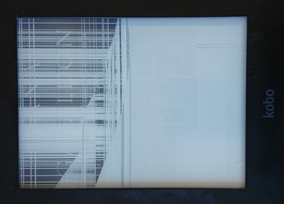

Here is a picture of the screen.
As I said, initially the whole screen was covered with lines, after two reboots the lower half of the screen went blank and the device is locked now, not responding to reset.
It has not been dropped or abused other than normal use. It was left in the sun for a while, I was kind of wondering if there was some sort of uneven expansion which may have caused this.

I'm afraid that's a classic picture of a fractured screen substrate. It's absolutely certain that this is what's happened, although obviously I don't know how it happened. Unfortunately a fractured substrate is not covered by warranty - it's physical damage.
I don't think Kobo devices are any more (or less) likely to suffer from screen fractures than any other brand, but it's one reason that I always keep my readers in a sturdy case.

I'll second everything Harry just said. That's for sure a broken substrate. My best guess it that you probably stressed or micro-fractured the screen due to twisting or bending of the device at some previous point and the expansion in the sun caused it to full fracture. Amazon seems to be more lenient in replacing devices but they are replacing them strictly for customer relations even though the damage was customer caused.

I have no reason to doubt that Harry and robko are both correct and that the substrata is broken. It kind of makes sense that the expansion from the sun may have been the needle that broke it.
But the fact remains that either I am peculiarly unlucky with my Kobo Auras, or the Kobos have an inherent problem which is not found in competing products.
I actually just did a little experiment with my last remaining working Kobo Aura HD, by applying minimal twisting pressure to the frame. Did the same with the Kindle DXG, which has both larger screen and is thinner than the Kobo.
The Kobo Aura exhibits noticeably more flexibility than the Kindle DXG. The Kobo actually squeaks under slight pressure.
Comparing the Kindle and the Kobo, the Kindle is considerably better made, with better fit and finish and less give, despite its thinness and larger surface.
Which would explain why three out of four Kobo Aura HDs have broken within their warranty period, while none of my other readers ever did.
Maybe the screens themselves are no more likely to suffer fractures than competing screens, but when placed in a substandard case and with substandard fit and finish, the likelihood of failures would be likely higher.

You might also consider getting accidental coverage for whatever ereader you get. You can get 3 years coverage for about $35.00 from SquareTrade, they often have 30% off. And as already said, keep your reader in a sturdy cover.
I've never broken any e-ink reader, but they're all made with the same delicate substrate layer that will crack if the reader is flexed at all.

You do realize that you possibly just cracked the substrate on both readers, and it's very possible it won't show up immediately. And when it finally does, you'll swear you did nothing to cause it (and at that moment you didn't).
