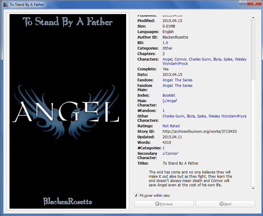

When I edit my Characters-metadata, it always reverts back to being alphabetically sorted instead of keep_in_order_characters:true. BetterRed mentioned this:
program:sublist(raw_field(‘#characters’), 1, 2, ‘,’)
But I'm unsure of how to make it happen.
You have to keep in mind that there are two different systems involved.
The keep_in_order_characters:true is a parameter in FFDL's personal.ini and effects how FFDL treats the metadata. The best way to see if FFDL is re-ordering your characters is to look at the characters line on the title page inside the epub.
If they are alphabetized there when you don't want them to be, I might be able to help with that.
Whether Calibre alphabetizes the characters after set by FFDL is a separate matter.
I suspect that BetterRed was suggesting using that code snippet to effect how Calibre is displaying your characters, possibly as a second display-only custom column. I don't know that part of Calibre well enough to comment off hand. But it's after FFDL has finished with the data.
(Note that as you've quoted it you have 'smart' quotes: (‘,’ vs ',') I don't think those work in actual code.)
JimmXinu is online now

Thanks, I'll try to input this in my custom column and see if it makes a difference. I just didn't understand the raw_metadata-thing
I now get the following (see the Main Character and Secondary Character):
