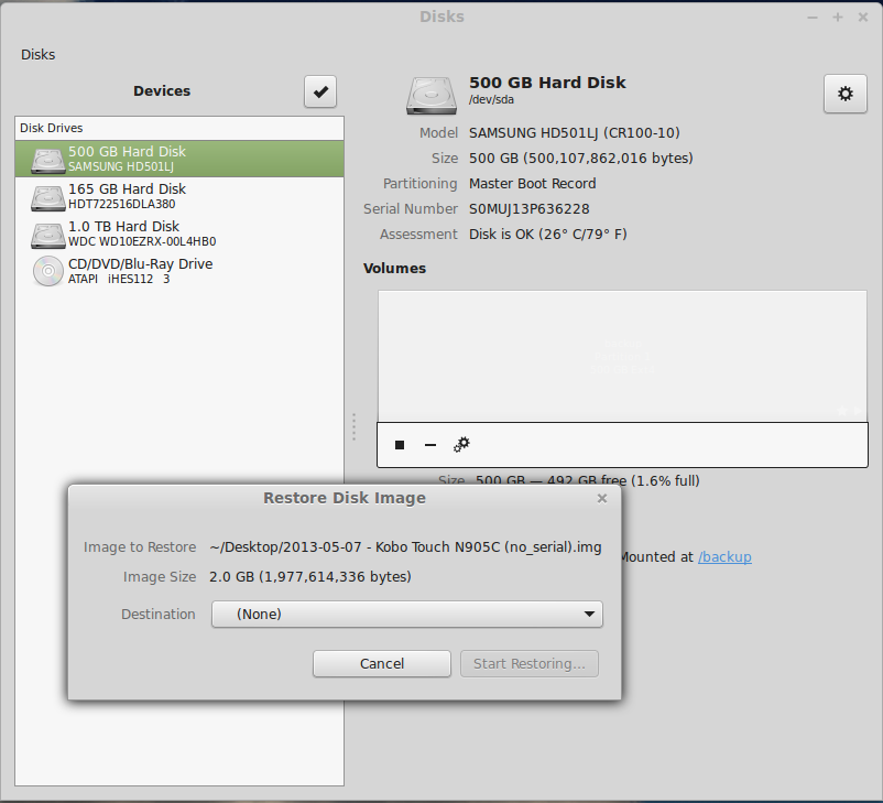

It summoned its "Disks" utility and asked to which device to restore the disk img. I choose the sd card and it wrote it there.
