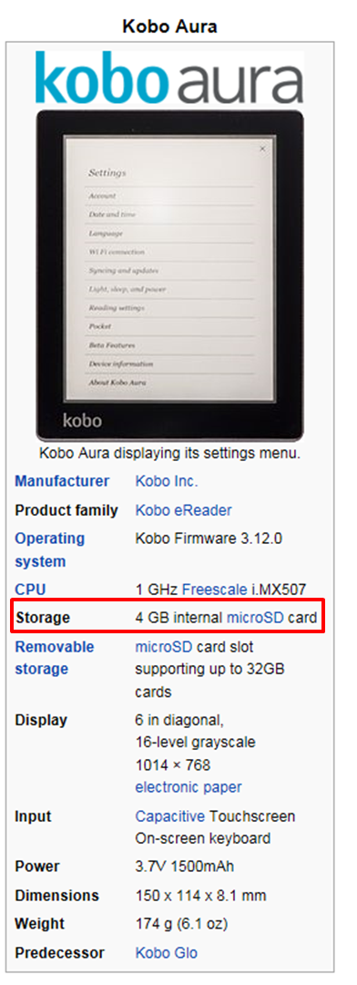

Do you have any evidence about No internal SD card?
As far as I can remember, the Kobo Aura does NOT have an internal SD card, so more than likely you will be unable to replace the OS by Android or dualboot using it.
There is no evidence that the Kobo Aura does NOT have an internal SD card.
Wikipedia show that Kobo Aura HAVE an internal microSD card.
What is the truth?
I can't understand your answer.

Do a search here. People have opened their Aura's and found the internal storage is fixed. And posted photos. From memory of the discussion when the Aura came out, I think the storage is effectively a fixed SD card. But, as you have an Aura, you can open it and see for yourself.

As PeterT said, we are talking about the internal storage of the Kobo ereaders. This is used for the internal storage of books and the OS. Most Kobo ereaders have an internal micro SD slot with a card in it. This is only accessible by opening the device. A lot of people have opened their ereaders and replaced the card with a larger one to hold more books. Others have written different images on the card to run other OSes or to restore function after a disaster. But, the Aura and the N905 version for the Touch have fixed internal storage. That means that trying some of the other functions people have created is either impossible or risks bricking the ereader if something goes wrong.
The micro SD slot you see is for extra storage. It is what most people are referring to when they are talking about using an SD card. If you see "internal" or "image" in the discussion, then it is probably about the internal card.
