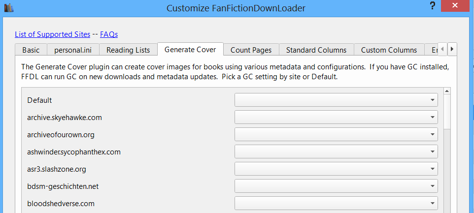

Originally Posted by firefoxxy View Post
I hate to have to go back to this old issue, but I still am not able to get the plugin to use those little icons from fanfiction.net to make a cover.
FFDL tries to recognize when an author picture is being shown instead of a story picture so it can avoid using author pictures.
Please post a story URL you're failing to get the cover for so I can see if it's really an author picture.
I set the options in the FFDL (see image)
Judging by the picture, you download to epub, that's good.
I do have only one configuration in the "Generate Cover" plugin, which is the "default". I did activate the option that the personal.ini overwrites the plugin. (Sorry if this is garbled, but I run the German version and have to re-translate.)
You're trying to get the site cover--Generate Cover replaces any cover from the site. So you don't want GC. On the FFDL config Generate Cover tab, set Default and www.fanfiction.net back to blank if you've changed them.
My personal.ini says:
Using your settings (and nothing else in personal.ini), I successfully get cover images from ffnet.

First, thank you for your answers.
Jimm: I do download as epub. The settings in Generate Cover are at "default". All other entries are blank.
Here is a story I just downloaded
https://www.fanfiction.net/s/6233004/1/
And the result is this
http://sta.sh/07wmuvxxsws
Should I remove the settings from the personal.ini then?
The cover you show is from Generate Cover. The "default" you are seeing is the name for one of the GC settings. It has to be blank, not default, to prevent GC from running. See attached.
This is another problem--that story doesn't have a story image--it's showing the author image. Go to the author page and you'll see it's the same for the author and all of their stories.
Here's an ffnet example that does have a story image.
If you decide you'd rather have the author image than no cover image, add this to your personal.ini:
[www.fanfiction.net]
## Remove author image exclusion
cover_exclusion_regexp:

Hello Jimm
Thank you so much for your help! It finally works. ^^

pagecache HIT: https://www.fanfiction.net/Harry-Pot...overs/224/357/
FFDL:INFO:calibre_plugins.fanfictiondownloader_plu gin.fanficdownloader.adapters.adapter_fanfictionne t(176):Fall back category collection
Python function terminated unexpectedly
'NoneType' object has no attribute '__getitem__' (Error Code: 1)
File "site.py", line 132, in main
File "site.py", line 109, in run_entry_point
File "site-packages\calibre\utils\ipc\worker.py", line 195, in main
File "site-packages\calibre\utils\ipc\worker.py", line 139, in arbitrary_n
File "calibre_plugins.fanfictiondownloader_plugin.jobs" , line 83, in do_download_worker
File "calibre_plugins.fanfictiondownloader_plugin.jobs" , line 83, in <lambda>
TypeError: 'NoneType' object has no attribute '__getitem__'

@Robin42069
I've got the same version, and can download from https://www.fanfiction.net/s/9443327/1/ without a problem
calibre, version 1.48.0 & ffdl from post #3909

i just downloaded and installed the new plugin and still same problem.its most likley a problem on my end as i said i got a crappy older computer and running windows xp and that messes up on me often sometimes so im not gonna cry over it to much. it still downloads most things. so not a huge problem
