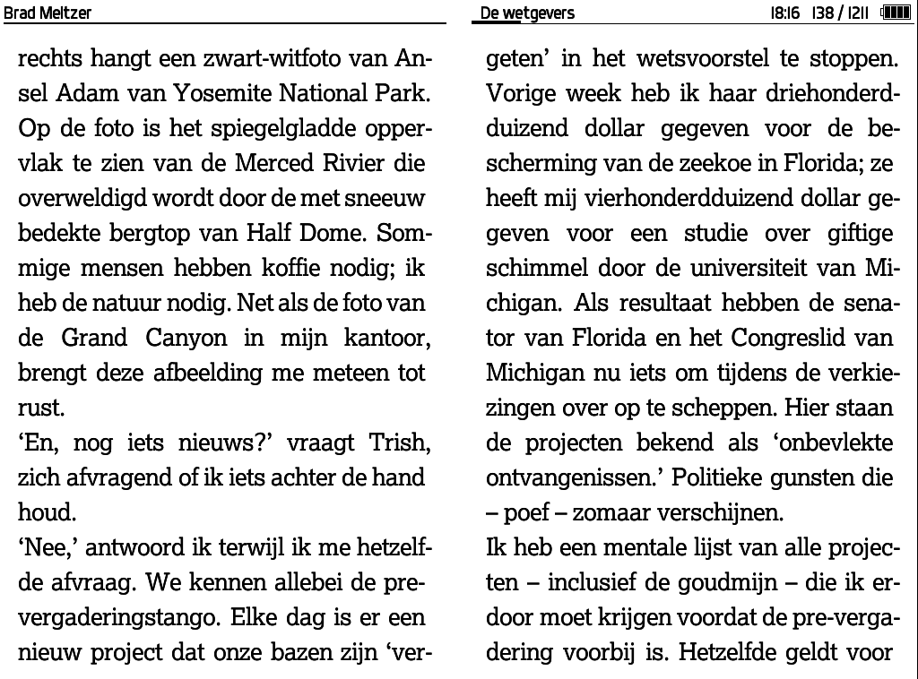

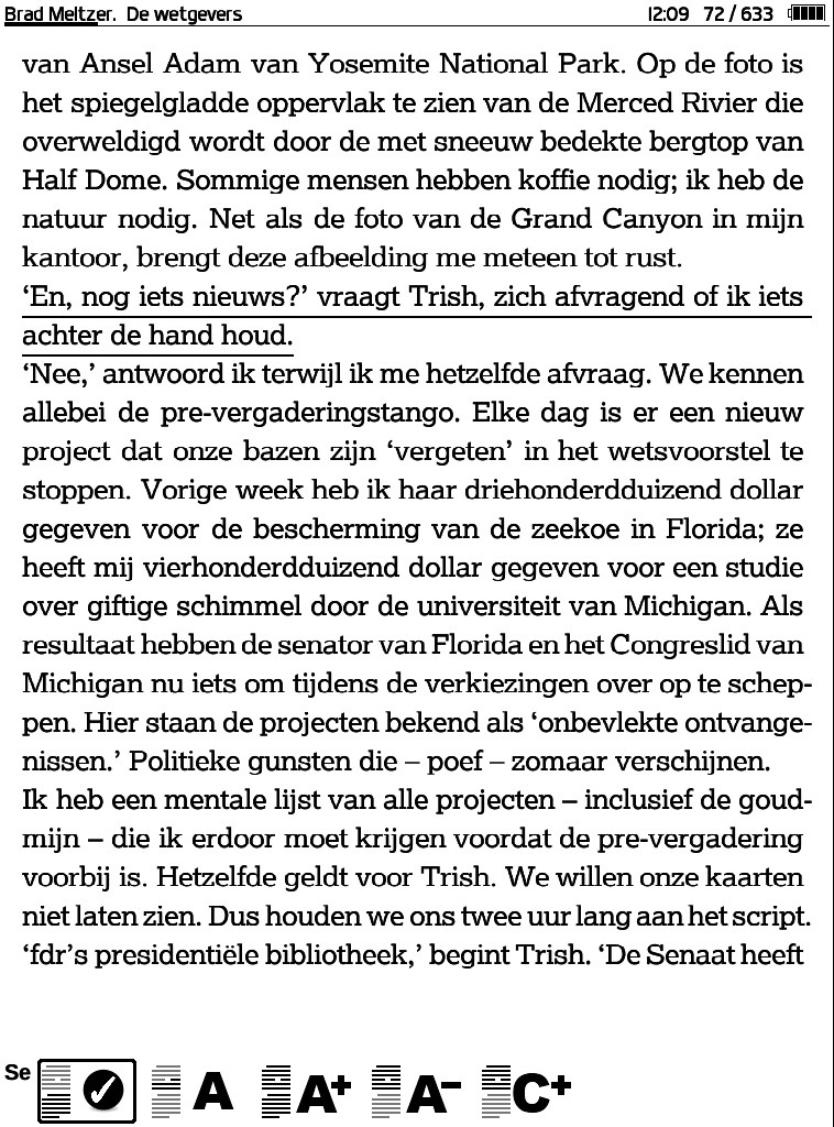

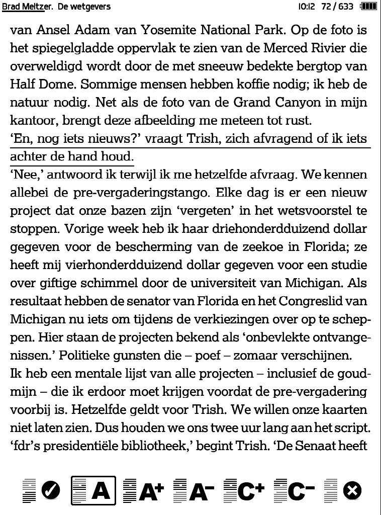

  • Still my greatest gripe lies within the buffering of the tap-actions which often result in unintended actions.
  • RUSsiya90 opted for a notes implementation but - although not the same - there's already a cite possibility in Cool Reader. Unfortunately it doesn't work correct. In picture 1 you can see it's some kind of scrambled; you can't use it as should and can't leave the cite dialog other than stopping Cool Reader.
    The v0.0.6-11 version of Cool Reader does work well in this respect (picture 2), but only in portrait display mode.
Some cosmetic suggestions:

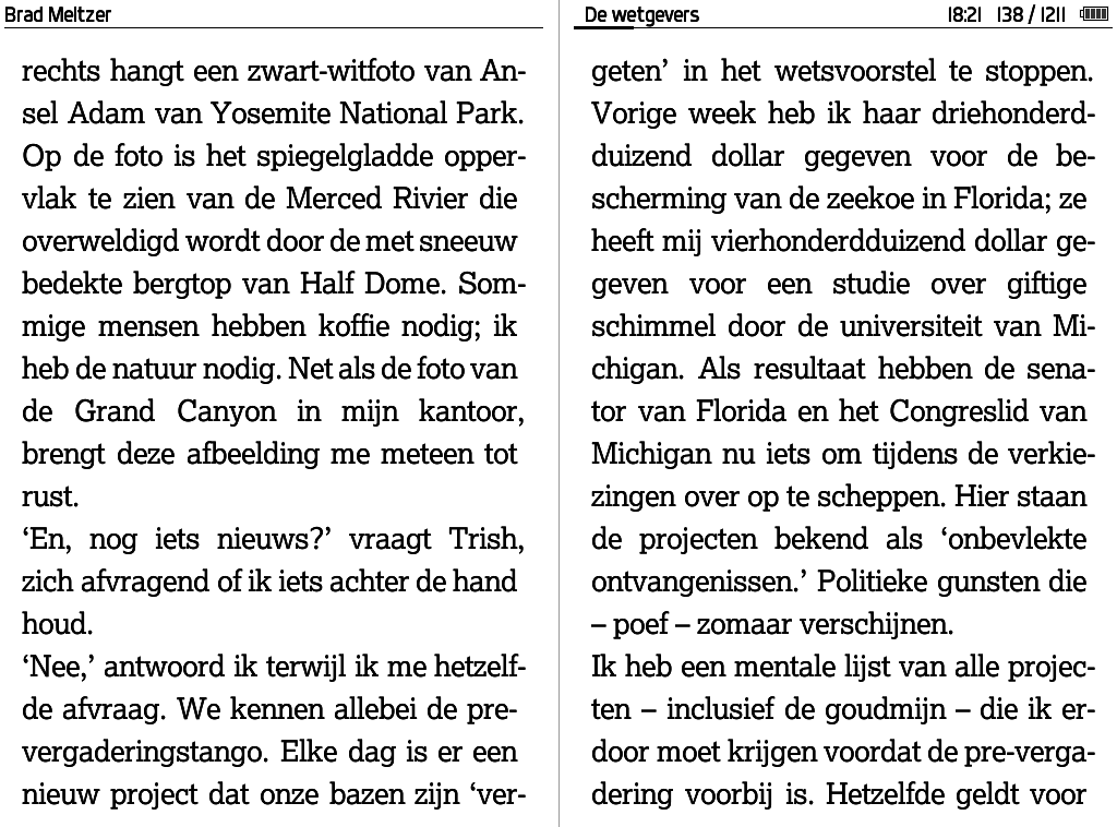

  • In 2 pages landscape mode it would be a nice addition to add a thin separator line between the to pages (pictur 3 vs picture 4)
  • Just nitpicking: text in menu's is cut off at the extreme right side (picture 5). Maybe it's a heritage from the regular skin with it's big selecting stripes.
As alway: keep up the good stuff!
