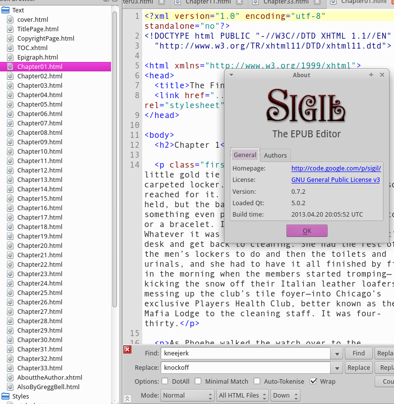

Who knows. I double checked though. In the screenshot I can't create an xhtml file. (I was trying to for the "Also by Gregg Bell." It just creates an html file. But in blank Sigil it creates an xhtml file. Who knows.

Could it be that it will use the extension xhtml if it is a blank ePUB or all the files are xhtml and html if the majority of the files uses the html extension?
You may be right, and if you're not, it's a very good theory.
