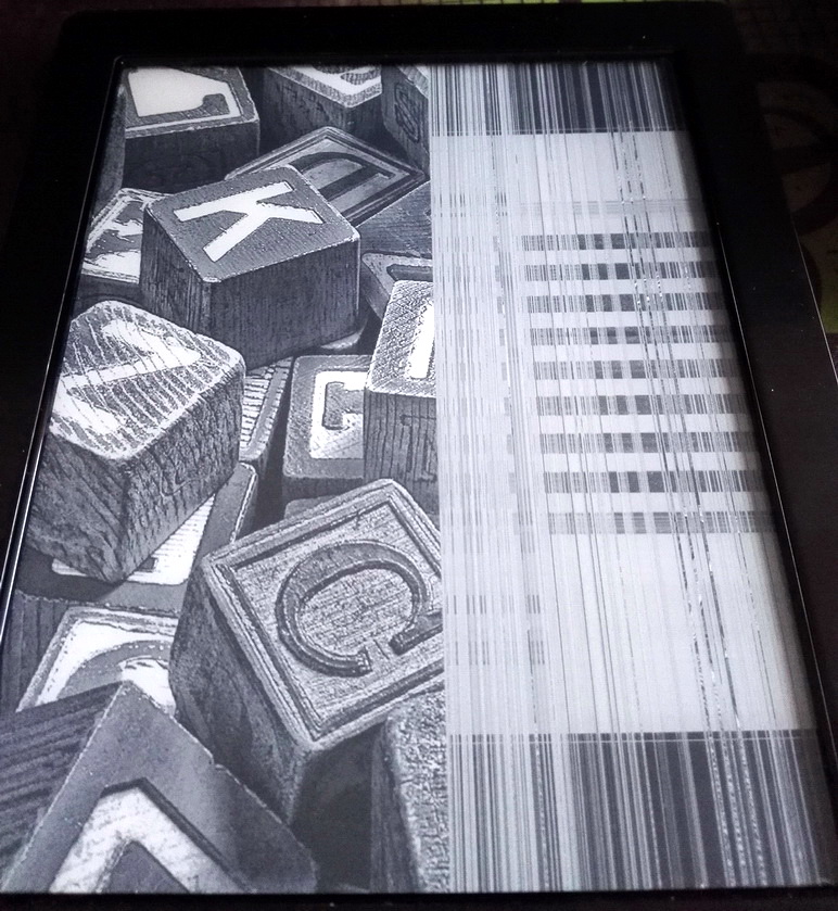

only one week, the screen is out of work!!!
I have used very carefully。 but only one week.

No obvious fracture in the picture so it might be one of those rare cases where you have a bad controller. Good news is that if that's the case it should be covered by warranty.
A broken substrate (not covered by warranty) will typically have a diagonal or curved line somewhere on the screen that I'm not spotting yet on this one. With only straight vertical/horizontal lines it's more likely a bad controller or other hardware issue.

Then contact whoever you bought it from or Kobo and organise a replacement! You either haven't used it as carefully as you thought or you were unlucky enough to get a "lemon". It is apparent from the lack of complaining posts in this forum and elsewhere on the net that there is no problem with the production quality of the H2O. If the point of your post is to suggest that people not buy one on the strength of your experience alone, then I don't see any reasonable person following your suggestion. If you think that someone is going to wave their magic wand and fix your screen, once again you are wasting your time. I know it is annoying. I myself would be angry and disappointed. But you must nevertheless be realistic, accept that you have been unlucky and organise a replacement.

There was an instance here recently where the curved part of the substrate crack was just under the bezel, clearly visible once the device was taken apart. Fingers crossed yours is a defect rather than the fracture it is perhaps more likely to be.
I think that may have been mine
Actually, you never showed that you had any cracks in your screen.
It's just what was assumed all around (also by Kobo).
