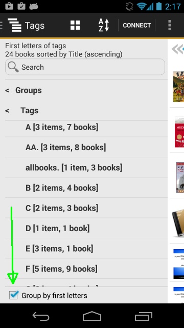

Somethin does not seem to work:
I gave "Tags" checked in CC as a hierarchical group. In Calibre under the category "Tags"
i see the tag "xxx.yyy" as a hierarchical tag: yyy inside of the xxx
But after sync in CC it appears as a flat tag: xxx.yyy
What am i doing wrong?
Have you checked the "first letter" box?
Note that the hierarchy in CC is one level. You see the first level in the first-letter display, then the rest of the levels a flat tag if you tap on the first level.
It looks something like the images in this post.

@chaley: no, nothing is checked under "choose groups that show first letter"
nikoski is offline   Reply With Quote
I wasn't clear. You need to check the first letter box, as shown in this image.
