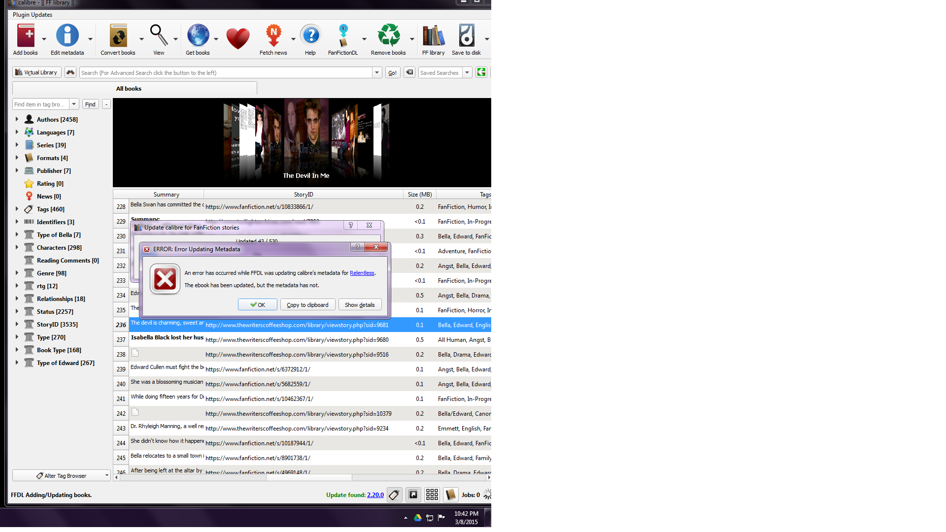

Still having this issue about meta data not updating. not sure what is going on, everything in my setting seems ok but who knows.
It's been a couple weeks or so and I, for one, don't remember what issue you were having. Looking back, I thought your issues had been addressed.
Please describe in detail what's happening and what you want to be happening instead. Include specific story URLs as concrete examples.
ok I attached the error Im getting and what it shows. Im going in and editing the site maybe its wrong link. Ill let you know

Well I'm pretty confused. You are using the latest version of FFDL and I tried it on my end with the very same version and seemingly can't reproduce the problem -- the update date is always scraped properly, in every scenario for me. Did you possibly change the skin settings in the site preferences at some point? If yes, do change them back to the default ("blueberry original") and try again. If that isn't the case, try deleting the story from your library entirely and downloading it again and let us know what happens.
I changed the skin back to blueberry Original I think Im going to do what you said and delete the story entirely and redownload it to see if that helps.
Really not sure why Im getting this error in the first place everything seems to be ok in my setting from what I can tell.

If you actually had changed the skin that's most likely the problem. It would explain the missing metadata (which I had) in your traceback and other things. You need to keep the skin at its default value for eFiction-based sites.
I think you are right about the skin cause I removed the old URLs and changed the skin. Issue gone thanks for that.
