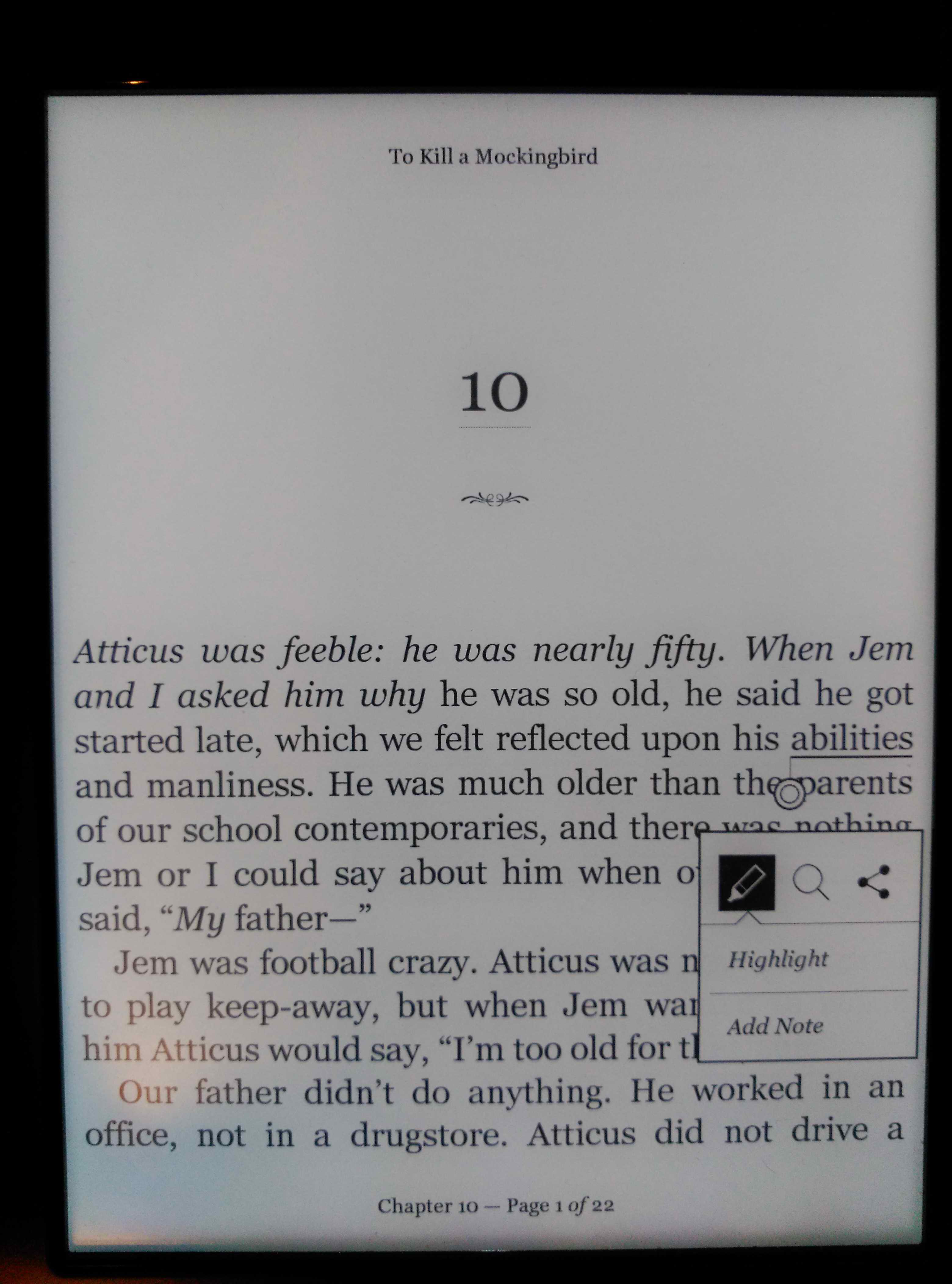

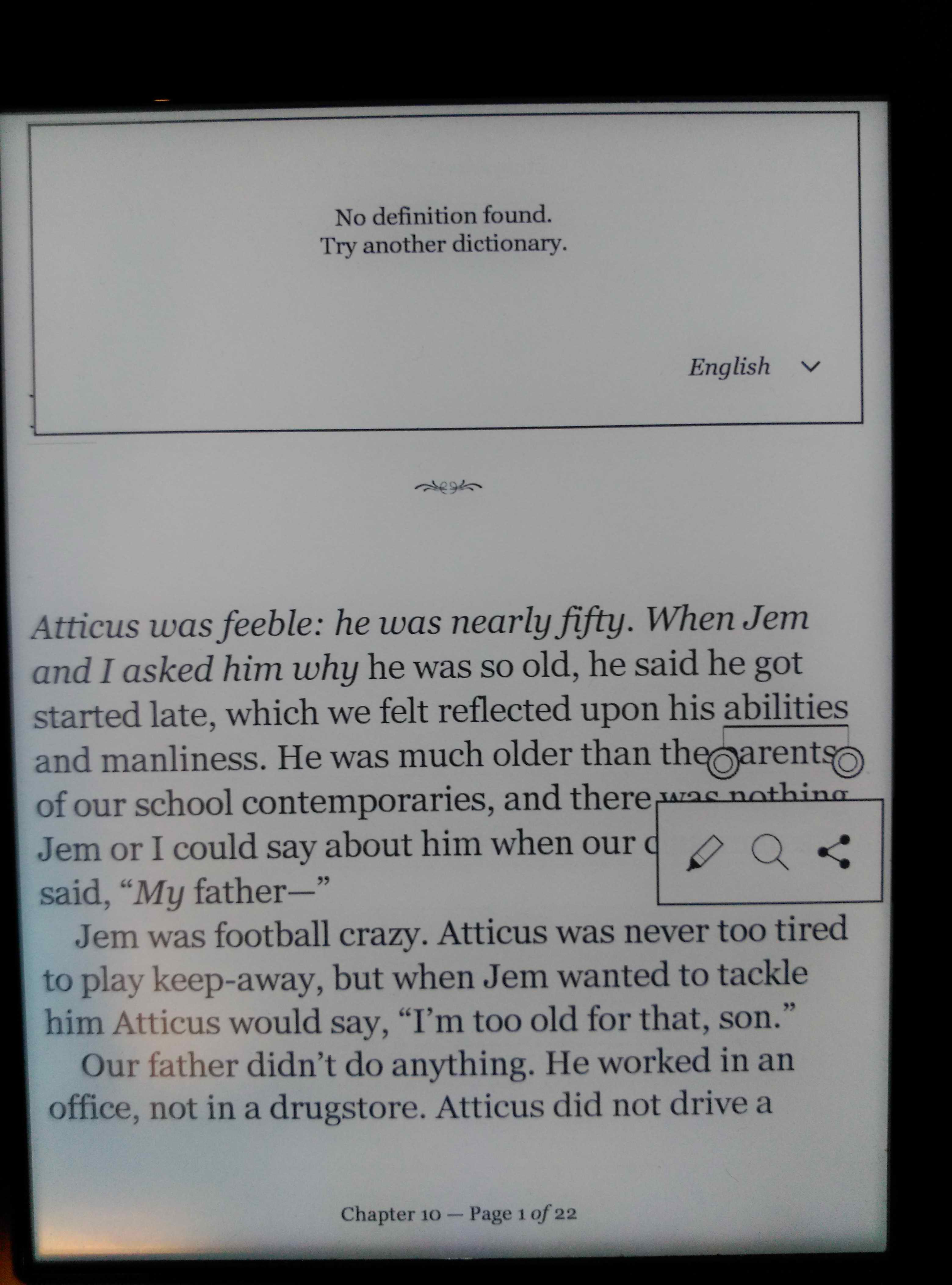

Hi guys, I think I've discovered a new bug (or at least I don't remember seeing it posted anywhere).
Look at the attached pictures. The problem arises when you long-press on a word in the right border of the screen in order to call dictionary and/or highlight it.
  • The right marker is missing
  • Dictionary is not called.
But this trouble doesn't appear if:
  • The text is not justified. (As example, in the other picture I've posted, I've just enabled left justification in GUI).
  • The word has a punctuation mark after it (a comma, a dot, whatever).
I've tested this issue in several kepubs, both sideloaded and original ones from Kobo bookstore.
Could anybody confirm it?
Yep, you're right. I'll report it.
I'm not seeing this on my Aura HD running 3.13.1.
I only have side loaded kePubs with full justification. Long pressing a word on the very right always seems to call up the dictionary correctly for me.
dordale is offline   Reply With Quote
Old 03-12-2015, 09:22 PM   #98
pickyaxe
pickyaxe ought to be getting tired of karma fortunes by now.pickyaxe ought to be getting tired of karma fortunes by now.pickyaxe ought to be getting tired of karma fortunes by now.pickyaxe ought to be getting tired of karma fortunes by now.pickyaxe ought to be getting tired of karma fortunes by now.pickyaxe ought to be getting tired of karma fortunes by now.pickyaxe ought to be getting tired of karma fortunes by now.pickyaxe ought to be getting tired of karma fortunes by now.pickyaxe ought to be getting tired of karma fortunes by now.pickyaxe ought to be getting tired of karma fortunes by now.pickyaxe ought to be getting tired of karma fortunes by now.
Posts: 302
Karma: 3817278
arspr I've also felt this "missing dictionary definition" bug multiple times on H2O 3.13.1, and though I haven't made a note of the conditions the bug appears, I do remember only seeing it on highlighted words that are at the end of a sentence.
Could it be also related to margins/padding? Could you check in the epub code if your books have margins in boby, div (if exists) or p?
(I ask for this because I always kill them in my sideloaded books).
