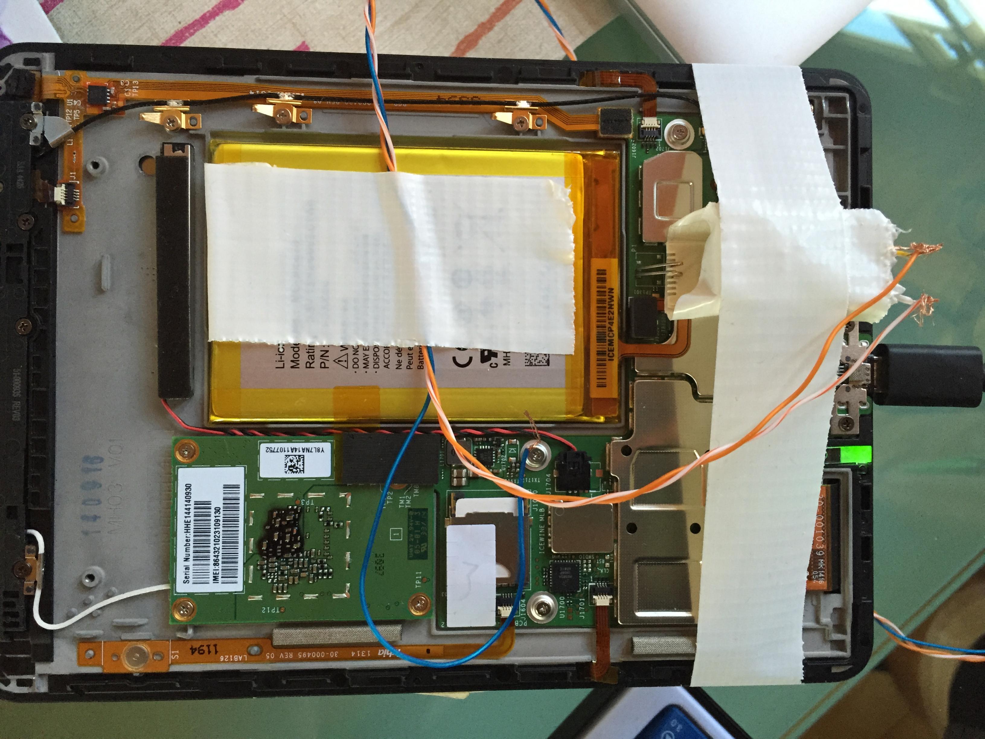

Solderless jb for KV
Used an old Ethernet socket and some tape.
