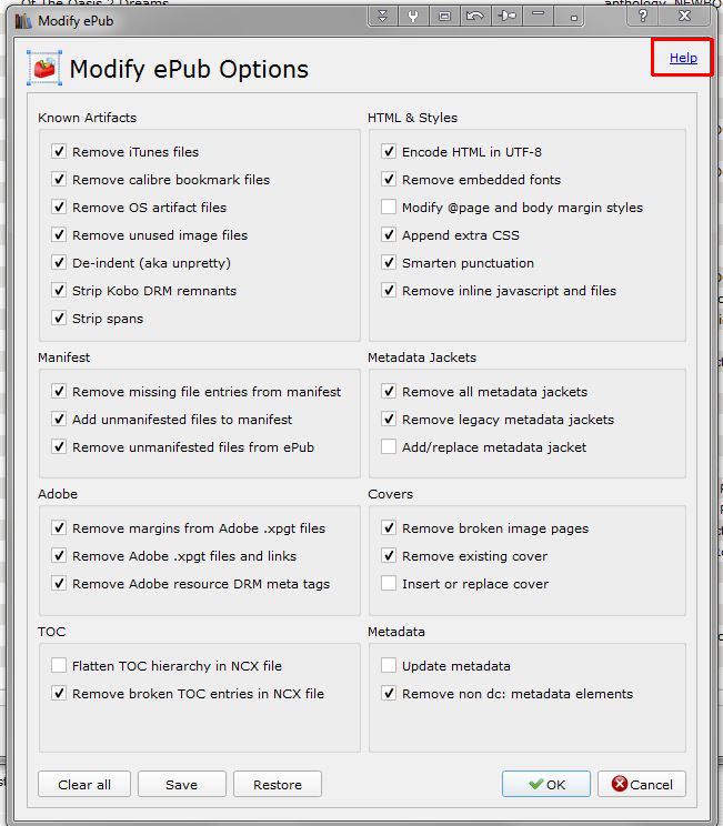

@mibtp - did you read this ==>> [GUI Plugin] Modify ePub first post and did you click Help in :

Yes, that is how I found the plugin, downloaded, installed.
