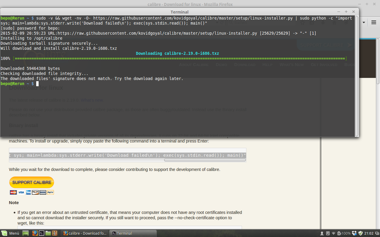

Last Sunday I tried to update Calibre from 2.18 to 2.19, but everytime I got the same error message
Downloaded 59464308 bytes
Checking downloaded file integrity...
The downloaded files' signature does not match. Try the download again later.
So, I tried at work, where I have a Linux Ubuntu 14.10 64bit what worked fine. Calibre was never installed there before. So I am coming home to try to update again on my Linux Mint 17.1 but again the error message posted above. I deleted the whole Calibre folder and tried to reinstall but still no difference, still this error message.
>> I don't think that the different Linux Distributions are the reason, because Mint is based on Ubuntu.
I upgraded my Linux Mint last week from Mint 17 to Mint 17.1, so I cannot exclude that this caused an issue. Is there anything someone could help with?
P.S.: I attach the error message to this post.
Regards,
Zauberlehrling!

Main download location: http://status.calibre-ebook.com/dist/linux32
Alternate, HTTPS-enabled download location: https://github.com/kovidgoyal/calibre/releases
Do these have the same checksum when downloaded at home?
What is the checksum for the faulty download?

Well I didn't check the checksum, also at work we have 64bit and at home I have a 32bit. Nothing really worked. At the end I deleted Linux completely and did a fresh and clean installation of Linux Mint 17.1 and now the installation works again.
