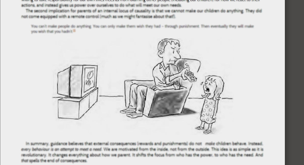

This is a long-running discussion or disagreement between NJ and I. He insists on telling newbs to always set ALL their images to width="100%" for mobi. I've repeatedly said that this is a bad idea, because the images can overdrive, if the reader uses a very large reading pane. {shrug}.
I'm not going to keep arguing with him. If I wanted to do that, I'd go post over at the KDP, where the lunatics really have taken over the asylum. (Not meaning you, nj--it's just simply vile in there these days.) He'll persist in doing what he's doing until he has a reason to do otherwise.
This is an image set to a simple % of the window--with a SINGLE-page view, in K4PC. You can see the single-column width of the reader overdriving the image into fuzz, although at "regular" or even remotely regular size, it's fine. This isn't even a good example--I simply had it to hand. If I put my mind to it, I could find a lot of really awful ones.
Hitch

The image is the identical size in single-pane view; it merely shifts to the left.
I used the wider pane to show that it doesn't expand to fill the width of the screen (or pane), which is what I understood you to be saying. ("end up with grossly overblown images.")
The image is an old one, 537x713 pixels, 25.9KB. It's true my eyes are old (as compared, say, to my knees, which are newish) but I just don't see anything unsatisfactory in how it appears on my computer monitor. I suppose I must now shell out for a PaperWhite II or Voyage, sigh.

That image looks like a jpeg that's over-compressed. What's needed is a new version of that image that's not been over-compressed.
