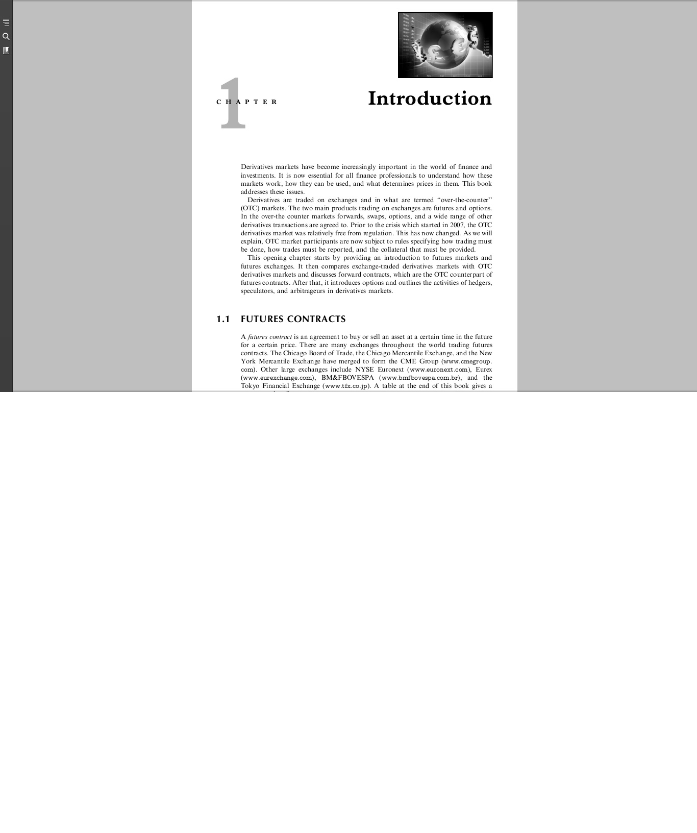

Hi guys,
I'm trying to convert an azw4 book to PDF. I have tried three different softwares including calibre. The problem, however, is that I want it to look like when I'm reading it in Amazon Kindle software. When I convert it, the size becames small and the tables and indexes are all messed up, to speak of the graphics.
I don't know what I'm doing wrong. All I want is to have the book in a PDF format similar to the hardcover book, which Kindle Software does pretty well (if I could print from Kindle, all my problems would be solved). I use my notebook touch as my ebook reader.
Below, I'm going to show you the format I would like to have in the PDF. Can someone teach me how to do this kind of conversion or direct me to some guide? The entire material I've read up to now was to convert between ebook formats and to remove DRM and neither is what I'm looking for (my file is not protected). I just want to have it in PDF in the same way it is shown in Amazon Kindle software.

AZW4 is a PDF wrapped in a Palm database. You can use KindleUnpack to extract the PDF, no conversions necessary or done.
See: https://www.mobileread.com/forums/showthread.php?t=61986
Also linked there is a calibre plugin (so you don't have to install Python if you have calibre)... or just use the Plugin updater directly from calibre.
Worked amazingly. Thank you so much.
