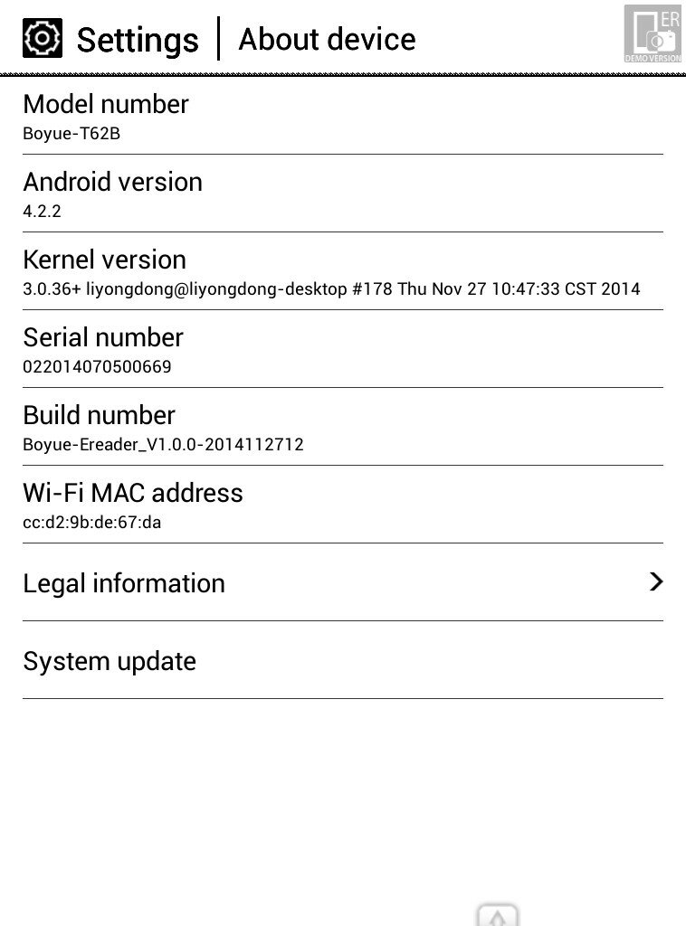

I was going to go back to the E653 rom but I got stupid and went to settings and checked for an upgrade after putting the zip in the root directory like I think I had to on my T68 and it started downloading an update. Turns out that wasn't a stupid thing to do. Since the update I've had no crashes and no freezing. Here's a screenshot from settings
Attachment 134198
Yes, that's the rom I'm on now. It's been smooth as silk for me so far. Glad it's working for you, too. Boyue seems to have fixed some bugs.

I guess you got this by checking for an update on your device and letting it download? The version in the first post is from 11/24 and mine is 11/27.
Yes, that is correct. As soon as I installed the 11/24 version, I checked for an update and there indeed was one. Only three days newer, it seems, but it does seem better all around.
