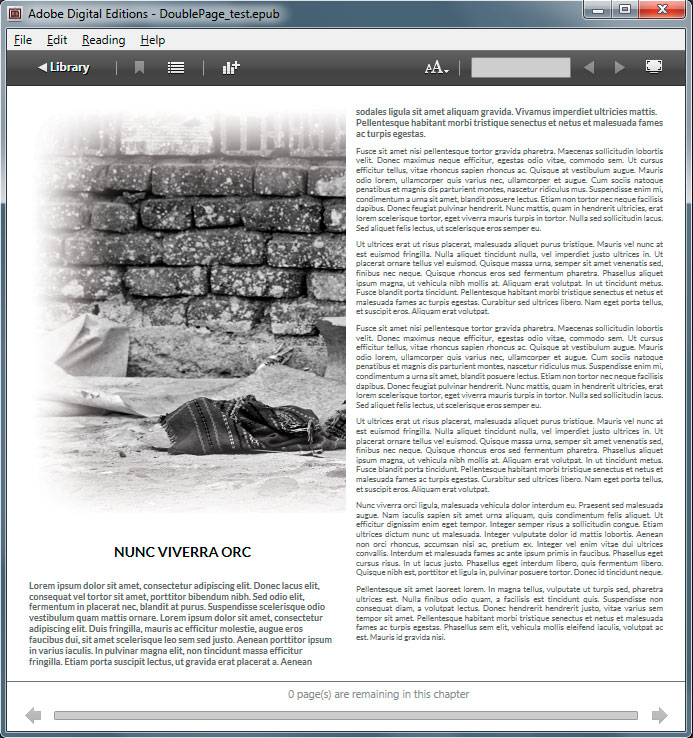

Hi everybody,
I'm so happy to find this forum. Hope I'll find someone to help me with this issue.
I'm quite new in EPUB creation, but using InDesign for many years (decades)... After watching and reading several tutorials I manage to create pretty complex epub from InDesign CC. Lots of text styles, pictures, colors...
But at the end I notice one problem I can not solve by myself and I need your help.

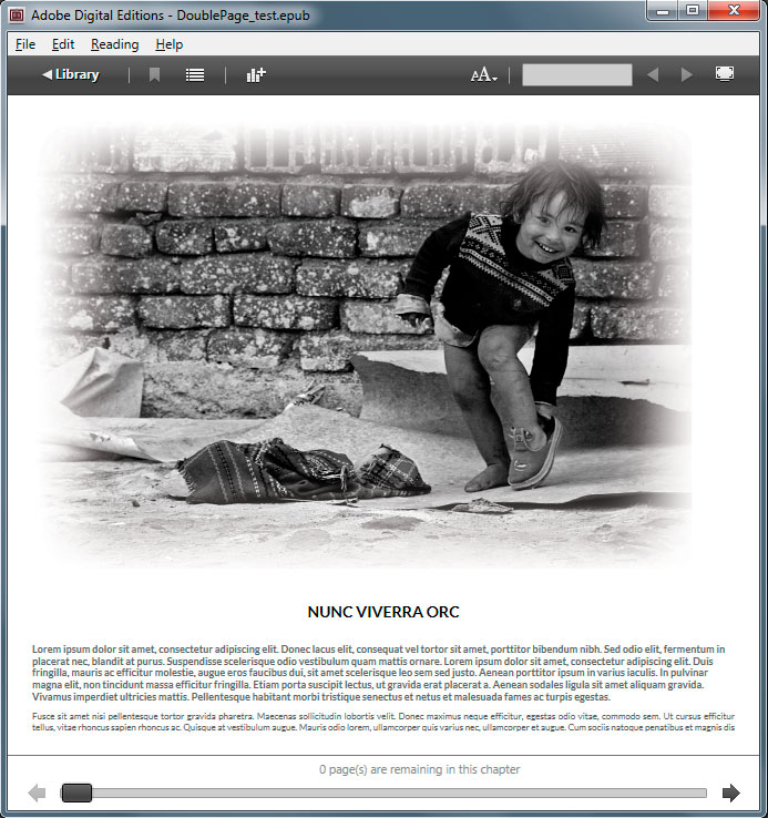

In ADE 4, when I switch to Double-page view, the picture (that use to be full widht) are visible only one half. Text flows good but photo do not resize. I tried all kinds of Object Export Options setup but it doesn't work. Does anybody knows how to solve this problem? Or to disable Double-page wiev when exporting?
Please, take a look at screenshots.
Thanks a lot!

I see this is an example. Perhaps you could post the ePub so folks and look it over to help you.

Interestingly it does not happen in Adobe 3.0 on the desktop. However widening the window to produce two columns does squeeze the image distorting it. Evidently the image proportions are not maintained. Now to study the source a bit and see what its doing. Thanks for posting this, it will take a bit of study.

Removing the height=100% from the CSS for the image fixed it in version ADE 3.0 and it looks perfect now. Someone else will have to try 4.0 as I don't have it loaded.
Dale
having height=100% would do it as it makes sure the image is the full height and if the width doesn't fit, off the screen it goes. ADE is like that.
Another option might be to try an SVG wrapper if this does not work in ADE 4.
