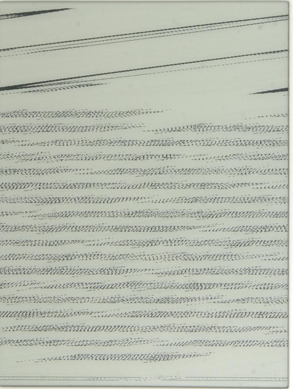

And this is how it looks like:
Yes, it looks like the pitch size (bytes for a single line) is detected wrong, more precisely pitch size is less than actual one used in the framebuffer device otherwise the application would very likely have already crashed.
So you can just hack this line: https://github.com/koreader/koreader..._linux.lua#L64 in the "koreader/ffi/framebuffer_linux.lua" file at line 64:
elseif vinfo.bits_per_pixel == 8 then
            self.bb = BB.new(vinfo.xres, vinfo.yres, BB.TYPE_BB8, self.data, finfo.line_length)
else
this way:
            self.bb = BB.new(vinfo.xres, vinfo.yres, BB.TYPE_BB8, self.data, finfo.line_length + 4)
else
or:
            self.bb = BB.new(vinfo.xres, vinfo.yres, BB.TYPE_BB8, self.data, finfo.line_length + 8)
else
until you make it right.
I agree, it must be the pitch size. I tried a few combinations of TYPE_BB4, ...8, ...16, etc. with different increments of the line length without seeing a way forward. It changes but not in the right way. Line length increments greater than +4 crash the program. Can it be that this display type ist not yet defined? Or somewhere else in the code?

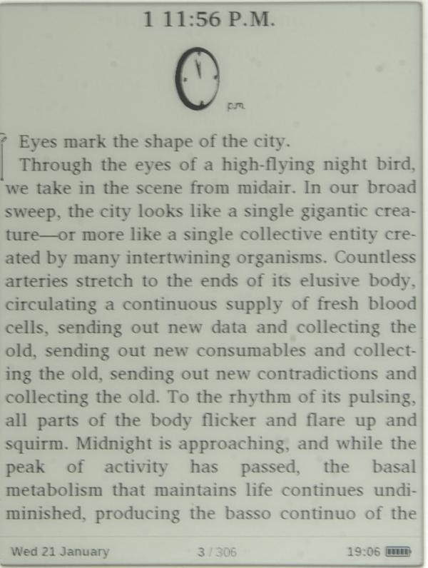

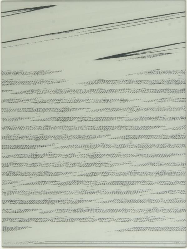

Yes, the screen should change when you set different pitch size. I still suspect it's only because of wrong pitch size. And I wonder what it would look like when you set pitch size from finfo.line_length + 1 to finfo.line_length + 4, could you do me a favor to make a screenshot for each of the four cases?
And you can also try to change finfo.line_length with finfo.smem_len at that line. Probably smem_len could be more accurate that line_length in PocketBook.
Here come shots of the result with line_length+0..4 plus how the page looks like in FBReader. The picture of the clock on top is least distorted with +4 but still way to goand with +5 it crashes.
Likewise, using smem_len gives a segfault.
ID:	134032   Click image for larger version
ID:	134033   Click image for larger version
sadowski is offline   Reply With Quote
Old 01-21-2015, 03:14 PM   #30
wirtold
wirtold began at the beginning.
Posts: 19
Join Date: Jan 2015
Device: InkPad 840, InkPad 740
1. For scrolling in PDF it should not be accelerating at all by design. If it does, it must be a bug. In EPUB documents I don't know.
Ok, i've checked this on PDFs. It rather looks like touches are buffered or queued: when i touch screen and move finger, for example, up-down-up, faster than screen is refreshing, and then raise my finger, koreader continues to repeat my moves: document is scrolled up-down-up.
2. You can use two fingers swipe right together to show the Table of Content. And use two fingers swipe left together to show the Bookmark window. More multi-touch gestures are documented in the project wiki linked in the first post.
Ok, i just can't find a way to zoom any part of document
4. Probably not, you need to copy fonts into applications/koreader/fonts directory in order to use them in Koreader.
It is working for me, thanks!
wirtold is offline   Reply With Quote
