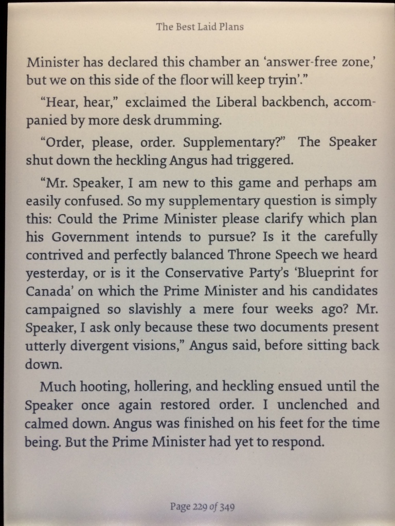

As an aside, if you have a Mac, Elena makes for a very nice reading font in my opinion.Click image for larger version
