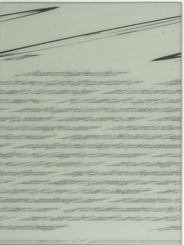

And this is how it looks like:
Yes, it looks like the pitch size (bytes for a single line) is detected wrong, more precisely pitch size is less than actual one used in the framebuffer device otherwise the application would very likely have already crashed.
So you can just hack this line: https://github.com/koreader/koreader..._linux.lua#L64 in the "koreader/ffi/framebuffer_linux.lua" file at line 64:
elseif vinfo.bits_per_pixel == 8 then
            self.bb = BB.new(vinfo.xres, vinfo.yres, BB.TYPE_BB8, self.data, finfo.line_length)
else
this way:
            self.bb = BB.new(vinfo.xres, vinfo.yres, BB.TYPE_BB8, self.data, finfo.line_length + 4)
else
or:
            self.bb = BB.new(vinfo.xres, vinfo.yres, BB.TYPE_BB8, self.data, finfo.line_length + 8)
else
until you make it right.

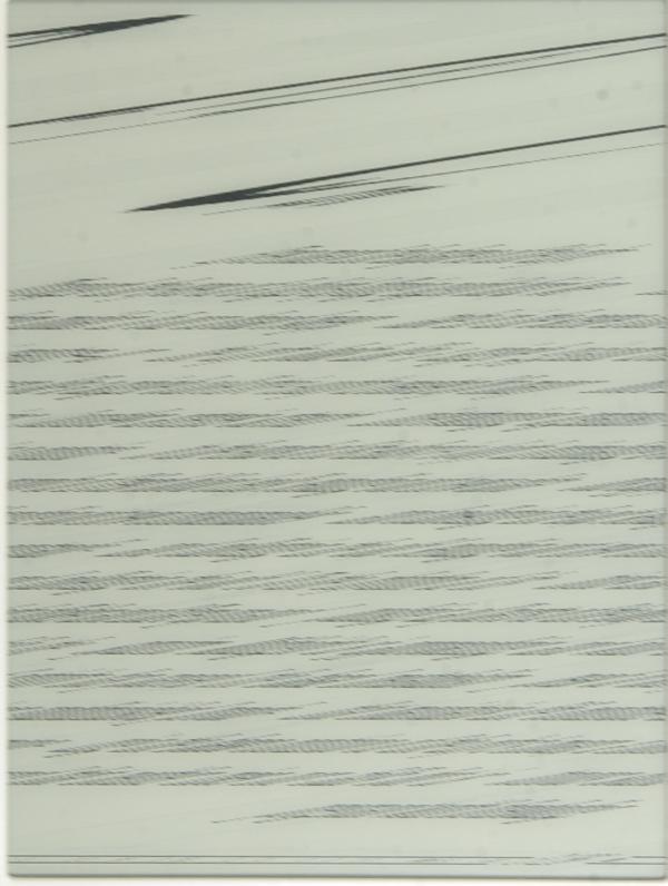

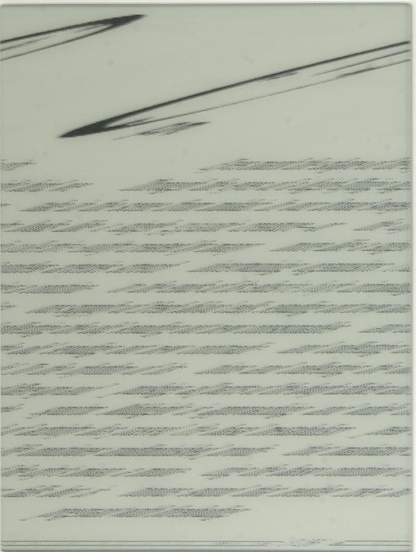

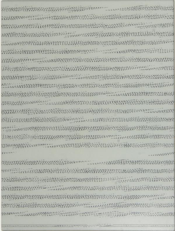

Originally Posted by chrox View Post
Yes, the screen should change when you set different pitch size. I still suspect it's only because of wrong pitch size. And I wonder what it would look like when you set pitch size from finfo.line_length + 1 to finfo.line_length + 4, could you do me a favor to make a screenshot for each of the four cases?
And you can also try to change finfo.line_length with finfo.smem_len at that line. Probably smem_len could be more accurate that line_length in PocketBook.
Here come shots of the result with line_length+0..4 plus how the page looks like in FBReader. The picture of the clock on top is least distorted with +4 but still way to goand with +5 it crashes.
Likewise, using smem_len gives a segfault.
ID:	134032   Click image for larger version
ID:	134033   Click image for larger version
sadowski is offline   Reply With Quote
