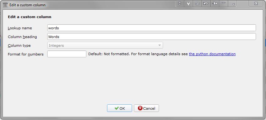

@sophieturgeon - does the ePub have any words in it - it is possible to have a book composed entirely of images - ie a picture book (comic) ?
Is there a word count in the log, as in
Count Page/Word Statistics
Logfile for book ID 245 (Test Book)
Found 94047 words
245
InputFormatPlugin: EPUB Input running
on C:\_CalTemp\calibre_r2ub25\bsv4pg_count_pages\245. epub
Found HTML cover titlepage.xhtml
Word count: 94047
The column you created for the word count must be Integer, as in
If they don't help can you post screen captures of the PI customisation and custom column(s) definitions - use the Manage Attachments button below the Submit & Preview buttons

Actually, while reading your post, an idea came to me. I think things may be working. Give me an hour and I will be able to confirm. You are a genius!

I just tried to add the page and word info to 121 books. It work for all but 4 books. I believe the problem for these 4 books is because thy are from a publishing company for which we don't have a plugin yet. Of course it was a user problem: all the columns were created correctly except the names of the columns had the # in front of it. And I had put a 1 in the Format for Numbers field. Again, Thank you so very much!

The '#' in front of the Custom column lookup name is needed in searching, templates etc, but not when specifying the Custom column. I think the '#' acts as signal to calibre processing code that the column in question is a Custom column rather than a Built-in column.
If you're happy with 34567 then there is no need to format, but if you wanted 34,567 or 34.567 you would use "{:,}" or "{:.}" as the format. You may find this blog post on python formatting easier to comprehend than the the one in the calibre documentation ==>> Python String Format Cookbook. It covers the 10% of what I need to know, to do 90% of what I need to do.
