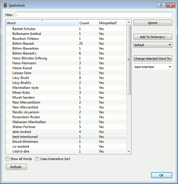

I personally tend to favor using the Spell Check tool as an alternate way to catch these hyphenation issues.
In the "Filter" box, I just stick a hyphen. This will show you every single word with a hyphen in it. Then you can quickly scan the list and see if you spot any oddities. For example, things like "-the" or "-and" will almost NEVER be correct. So when you have a sentence like this:
This is a sample sentence-this is an aside-and this is the continuation of the sentence.
In the spellcheck, you will see "sentence-this" and "aside-and". You can then investigate much more closely.
Depending on how many hyphens you have in your book, that could be another way to quickly go through and fix those types of errors.
