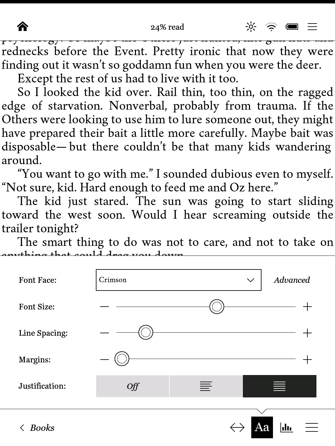

@GeoffR: That might be it, feeding it to Mantano leads it to try to open it as an epub3 (which fails spectacularly, FWIW) .
That said, I still (mostly) don't see anything cut-off, except for the very edge of the italic g on the left.
What I do see is stuff cut-off from the top/bottom, with some fonts/line-spacing combo, but that's on every kind of kepub (with or without the book-inner/book-columns divs), and might be related to my extreme lack of margins, and/or the fact that I only patched for the left/right padding (although that would only apply to stuff w/ book-inner divs)?
EDIT: Although I guess that's probably a question more related to full-screen mode/the patches than this, since you pretty much answered my original question about why those kepubs weren't getting the book-inner treatment .
The f in the font you are using doesn't have such a large right bearing as the f in Georgia, I wonter if you could try it with Georgia?
I'm pretty sure this is to do with the smaller line spacing that is possible with the patch. It seems to happen with recent firmware in the kepub reader once the lines start to overlap (which happens once you get the line spacing down to about 0.85, depending on font family).

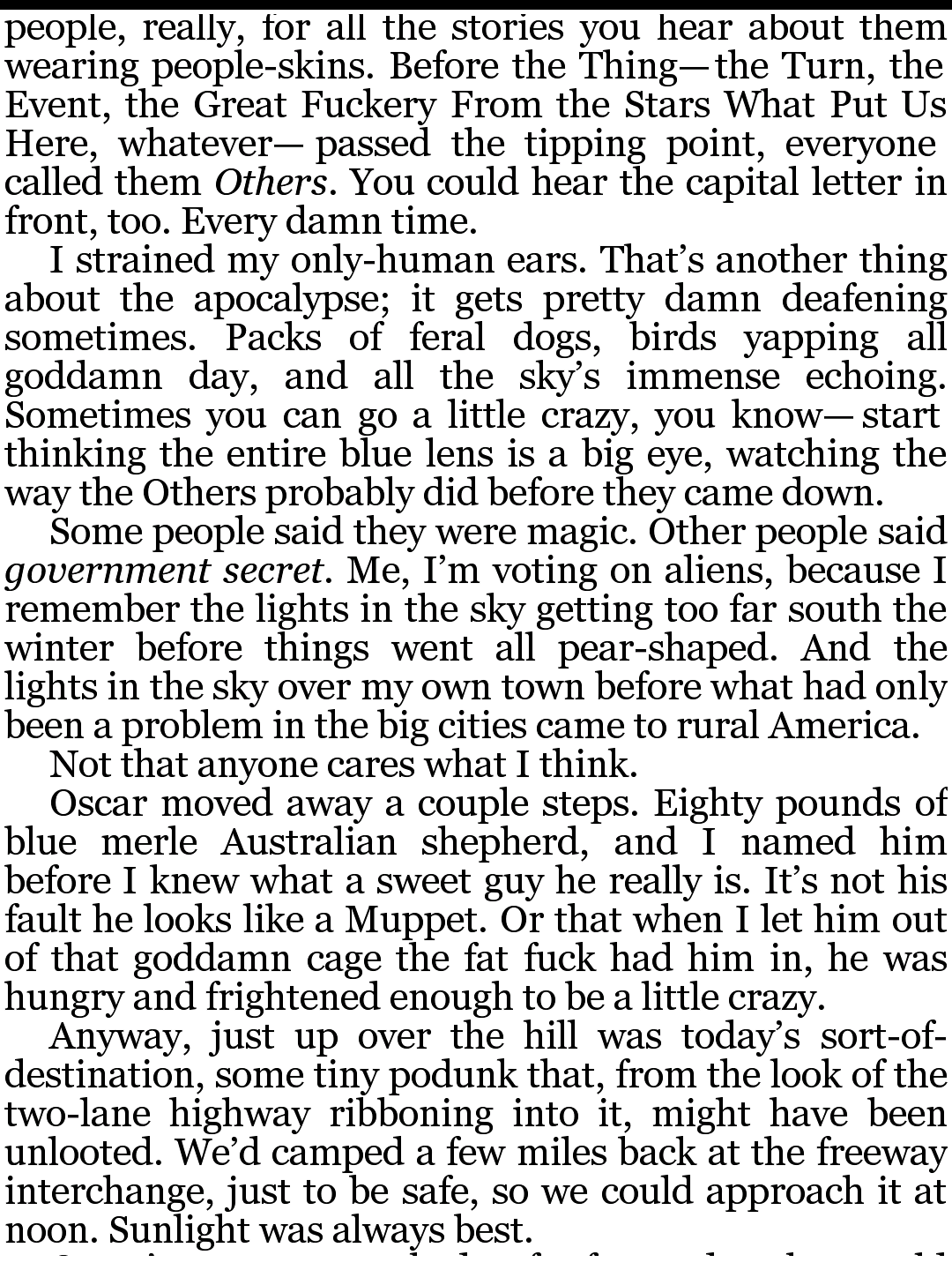

@GeoffR: Ooh, it's subtle, I missed it at first, since it's still fairly readable, and I'm not used to Georgia, but, yep, Gorgia's f's get chopped up a tiny bit!
So, to recap: all's well with the world, the patch is doing its job perfectly, we just have to know that synced kepubs than originated from an epub3 are constructed, and thus behave, differently .
As for the top/bottom thing, yep, thanks for confirming that, larger line-heights indeed help .
@jgoguen: Now that all my annoying questions have been answered, I'll clean up my GH tree and send the PRs tomorrow . Then we'll get to wait with bated breath to see how much I broke stuff for people ^^.
EDIT: Although I guess that means I'll first have to actually figure out what goes wrong with books using div's instead of p's instead of working-around the issue by not adding the book-inner/book-columns div's in those cases...
