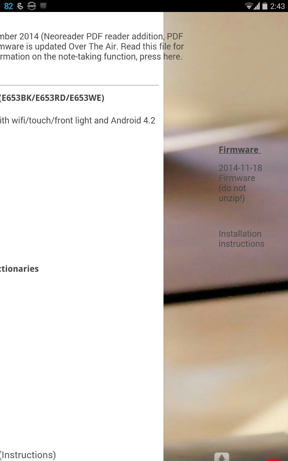

I don't see any firmware upgrade here for the Icarus Illumina E653. Did you use the Icarus Illumina HD E652?

Smile iCarius firmware is Dated 11/18/2014
It is for ICARUS Illumina (E653BK/E653RD/E653WE).
From iCarius official site and the link works at this moment:
http://194.33.112.113/~icarusre/open...ormation_id=11

I found it. It's not showing for me on the white part of the page so I missed it.
