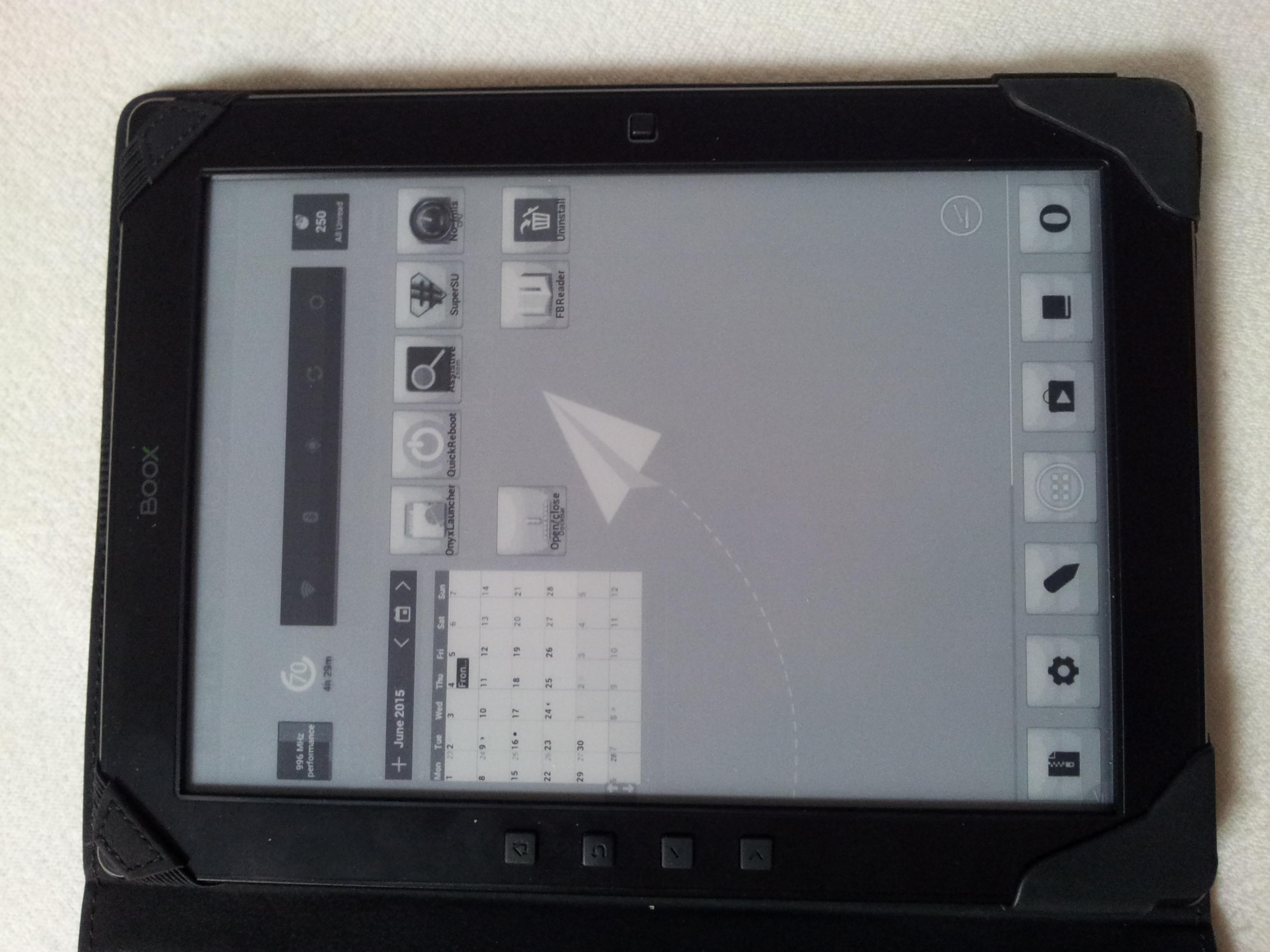

1. Download 'ADW.Launcher' for free (or the paid Version 'ADWLauncher Ex' -I recommend)
2. Go in ADWSettings => Screen => disable 'Wallpaper Scrolling'
3. Go in ADWSettings => APP Drawer => change 'Text color' to black (circle to bottom left corner)
4. Go in ADWSettings => Icons => change 'Text color' to black (circle to bottom left corner)
5. Go in ADWSettings => Folders => change 'Text color' to black (circle to bottom left corner)
6. Download 'Chrome Theme Go/Nova/Apex' Icon Set, and apply the icons in ADWSettings => Themes
7. Download 'Minimal Wallpapers', which are ideal for e-ink, and apply whichever BG you like.
DONE. After all this changes, it basically should look similar to mine (M96, attached picture)
eb00ker
