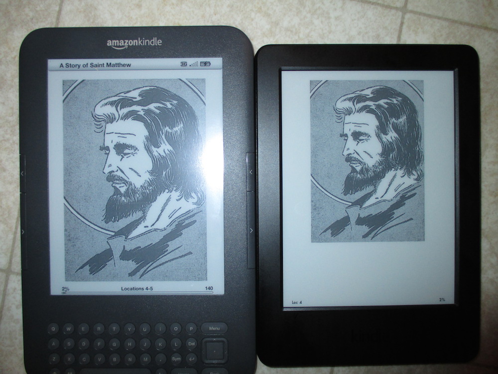

side by side screen shot
Yes, positive it was not hacked/customized as I have seen the files on multiple old kindles.
Here is the exact same file loaded on the old Kindle vs the New Kindle so you can see the difference in display.
The image is 503 x 700 in case that helps.
Any ideas how to fix this problem?

Ah, I see. When creating a Kindle book Amazon recommends to use color images at 300 ppi resolution with highest quality setting possible as long as each picture be less than 5mb. Only the cover image is allowed to completely fill the screen, the other images are a maximum of the width of screen minus margins, height depending on the width. That is if the picture is big enough. It also should be at least 600 px wide by at least 800 px high.
In your case the picture is simply too small by Amazon's standard. Try making it bigger - sounds like a lot bigger won't hurt. Just make it 1006 x 1400 for double resolution - that should go without hurting the IQ any. Load on both old K3 and new Kindle Basic - should look the same.

The recommendations I posted earlier are a mix of old and new. Mostly the new format. It is not necessary to resize your pictures any as long as you are willing to edit how the images are embedded either in epub or kf8 format.
Created an ebook just to test that out. And attached is the result in KF8, the epub source is simply this:

Both epub and kf8 are attached (quick done in calibre started as epub then converted to azw3).
Works both on my PW and KT to fill the whole page either with width or height set to 100%.

Depending what you used to convert (presumeably calibre) it probably "fixed" the KF8 (AZW3) automatically to emulate how the old mobi used to be interpreted on older Kindles that don't support the new KF8 format. Hard telling without looking inside.
