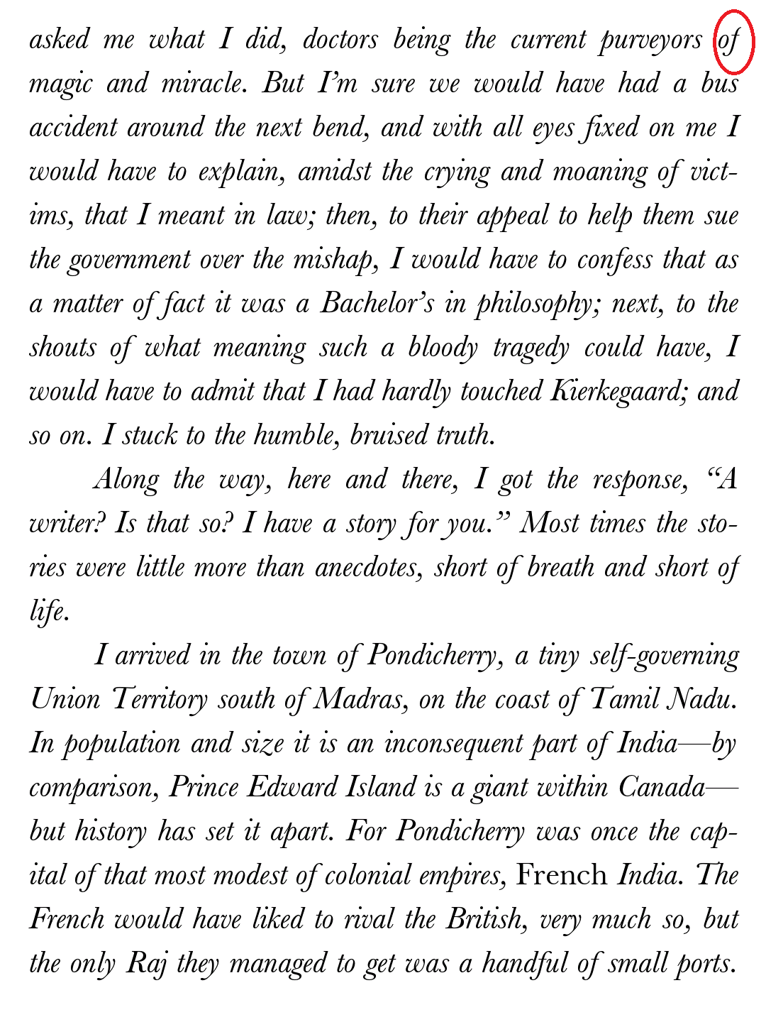

it seems that this kind of setting like body>p can't cover all sideloads kepub. I tested, some books work well and some not.
Is increasing the padding from 0.1em to 0.2em enough to fix it? Sone fonts will need more padding than others.
That's an interesting idea, it would have the advantage of avoiding any possibility of using the wrong firmware version to make the patch. I haven't thought about what would be needed to make it work though.
I'm afraid not. Because "body>p" and "body>div"only have effect on the first class p and div under body. However, in some books, the main text is in the second or more deeper class and it will not be modified with the patch.
That is the purpose of the body>div selector: the padding gets added to the outer <div>, so it doesn't need to be added again to the inner elements.
With synced kepubs the padding only ever gets added to an outer <div>, never to <p> or any other inner elements. With the sideloaded kepubs there is not always an outer <div>, so the body>p selector ensures it gets added to the <p> in that case.
With the earlier versions of the patch, the padding got applied both to the outer <div> and to the inner <p>, so there would be twice as much padding (or more, depending on how many outer <div> layers), which is why I think increasing the amount of padding in the latest version of the patch might be needed to get as much padding as was in the earlier versions.
You are right. I increase paddings to 0.2em and it works very well. Thanks!
