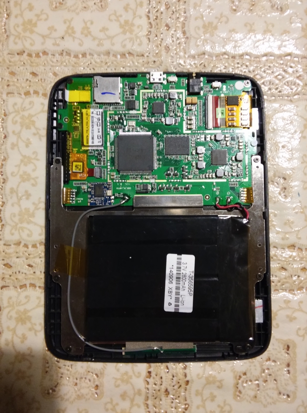

The device inside
See how the device looks inside. [See attachment]
