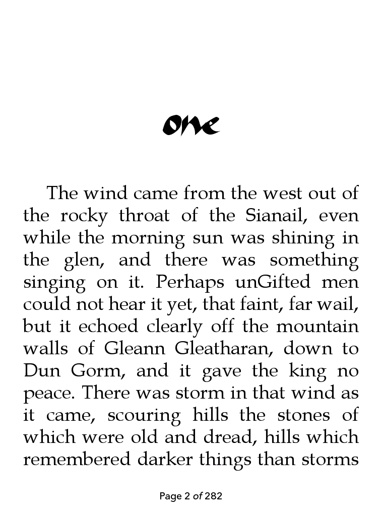

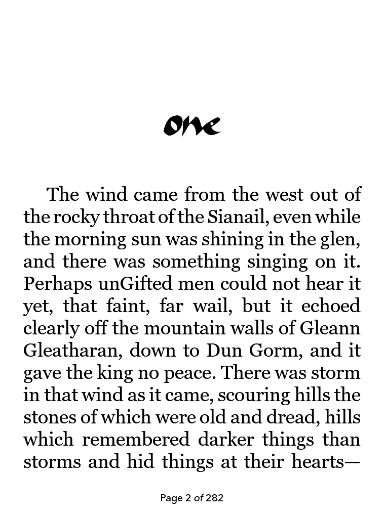

Edit: Screenshots from a book where the publisher has got it right: First shot shows the book with the font set to document default, chapter heading and main text are rendered in the publisher's embedded fonts; the second with it set to Georgia, the publisher's font remains for chapter headings etc. but the reader's choice overrides the font used for the main text.

Nice explanation! I guess these fonted heading imparts magical effect while reading quite similar to images and there is no place for a custom font to be inside paragraphs.
I like the embedded font used for the paragraph text too, it suits the fantasy setting of this book, but I find the plainer Georgia more comfortable for extended periods of reading.

so maybe it is due to individuals font preferences, to me second font with georgia is bit difficult to read.

Yes, individual preference of course. If the publisher has done it right then the main text can be overriden with whatever font the individual reader prefers if they don't like the publisher's choice.
But if the publisher tries to force the main text to always use the publisher's font then the result is that the reader will just strip all the fonts, and then the ornate headings etc. will be lost as well.

I agree. I almost always prefer to select the body text's font and text attributes that work best with the device in hand.
In the examples, I much prefer the left-hand example. The right-hand is too dense looking and needs more leading (aka "line spacing",...) to compensate the font's larger x-height. But that is based on viewing the screen shots on a large monitor. The only true test is done by viewing on the actual device being used.
