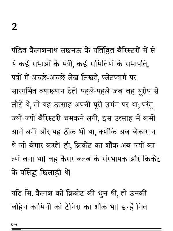

Hi friends,
K4 uses the Code2000 font to render all the unicode glyphs, including Devanagari. This font is adequate but is quite ugly as can be seen in the attached image.
K4 does not allow the installation of any alternative unicode fonts for a specific unicode range like Devanagari.
I want to do this:
  1. Edit the Code2000 font to remove all the existing Devanagari glyphs.
  2. Insert the Devanagari glyphs from Noto Sans Devanagari font into the Code2000 font.
The problem is complicated by the fact that unicode Devanagari fonts contain a lot of hidden information on how to handle ligatures. Every Devanagari font has it's own custom hidden information.
I am looking for friends who have the requisite font editing skills to solve this problem.
Thanks.

Please clarify, how will a font hack help?
I could have simply renamed noto sans as code2000.ttf and got good Devanagari text.
But then what if a book contains other unicode characters? They will not be displayed correctly.
Also Arial unicode can be renamed as code2000.ttf but it's Devanagari glyphs are too thin and not suitable for low-res screens like K4. Noto Sans is thick & custom built for mobile screens.
Another possible solution could be to get a Noto font that covers the whole unicode range. I'm looking for this but have not been able to find it yet.

Problem still not solved. Font hack is not the solution since it has no special provision for Devanagari fonts.
geekyworld is offline   Reply With Quote

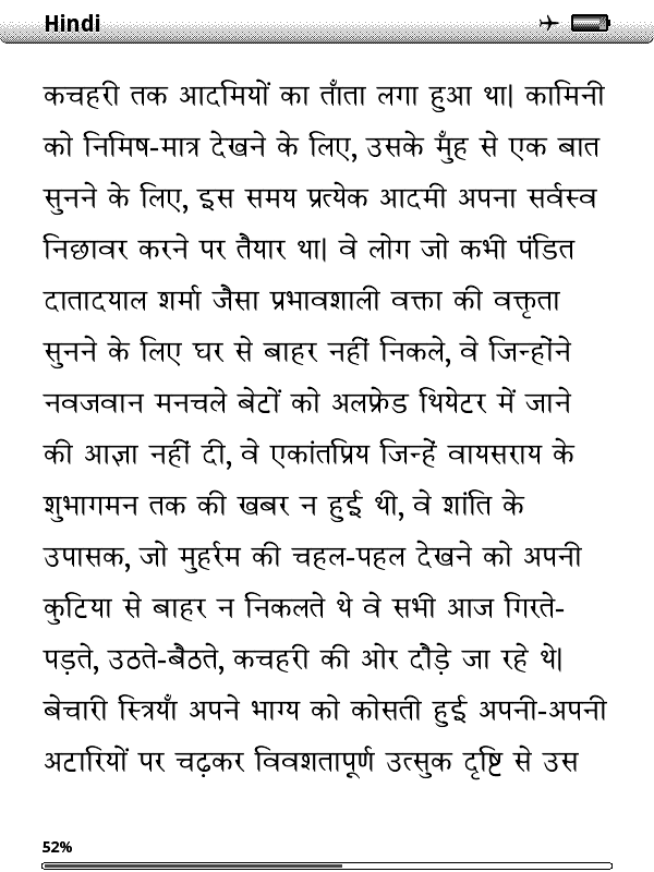

@NiLuJe Thanks for your detailed reply. It turns out that I18N font uses the exact same Devanagari glyphs as Code2000! So, Devanagari text looks exactly the same even after installing the font hack. View the attachment for evidence.
I'm really fed up of this and am closing this thread. I don't know about other devices but I think Indians should not go for Kindle because of the poor INDIC support and ugly fonts. I'll think twice about buying an Amazon product again. Bookshops should not get into the computer business in the first place. Bastardization of the first order!
