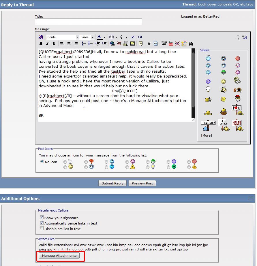

@rgabbert - without a screen shot its hard to visualise what your'e seeing. Perhaps you could post one, there's a Manage Attachments button in Advanced Mode - see attachment
