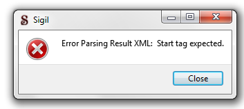

No problem at all. I replaced all the files and I do get further. Now I get a popup saying: Error parsing result XML: Start tag expected
Then I see the results, but they are not pushed to Sigil.

Hi Toxaris,
The second modified launcher.py should have handled that error but I guess it did not. DiapDealer has said he needs other files from the new launcher as well to get anything to work with the Sigil 0.8.1 build.
So I will put together a full set when I get home from work tonight and modify them to work with Sigil 0.8.1 so that you have something to continue development with while we wait for Sigil 0.8.2 to officially come out.

After installimg Sigil 8.1, I'm getting the following error from PunctuationSmarten.
Changes made to Text/East and West-Poems.htm
<?xml version="1.0" encoding="UTF-8"?>
<wrapper type="edit">
<result>success</result>
<changes>
<modified href="OEBPS/Text/East and West-Poems.htm" id="East_and_West-Poems.htm" media-type="application/xhtml+xml" />
</changes>
<msg>
</msg>
</wrapper>
crutledge is offline   Reply With Quote
Old 11-29-2014, 03:32 PM   #45
Doitsu
Doitsu's Avatar
Posts: 5,933
Karma: 24259515
Device: Kindle PW2
This usually only happens if invalid .html files are processed with plugins.
1. Did you check the epub with epubcheck before you ran the plugin?
2. Did you install PunctuationSmarten_v0.1.0.zip?
If you checked the epub with epubcheck (not FlightCrew) and installed PunctuationSmarten_v0.1.0.zip you'll need to attach an epub that generates this error.
