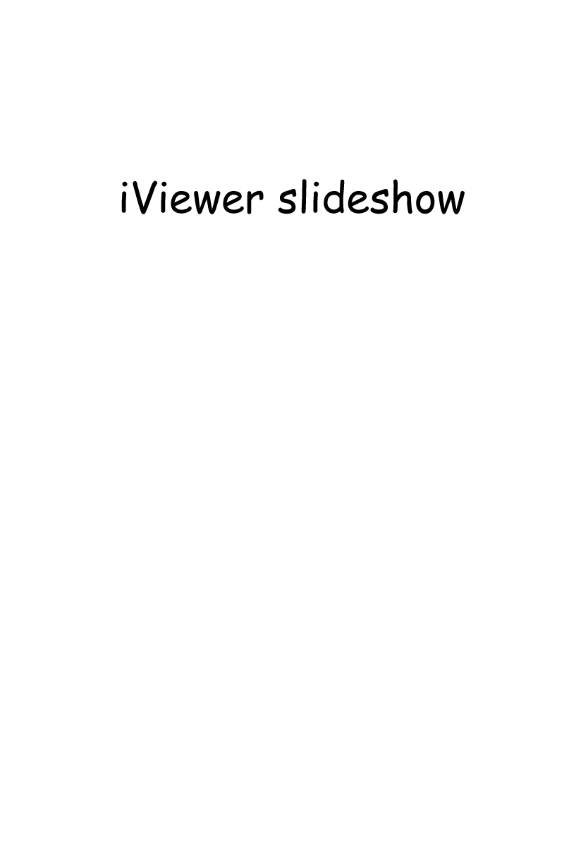

The files that launch iViewer are: .cbr .cbz and .gif . When you open .gif files iViewer scans the folder for all the images.

I included a gif image. Copy this gif in any folder with images that you want to see using iViewer.
