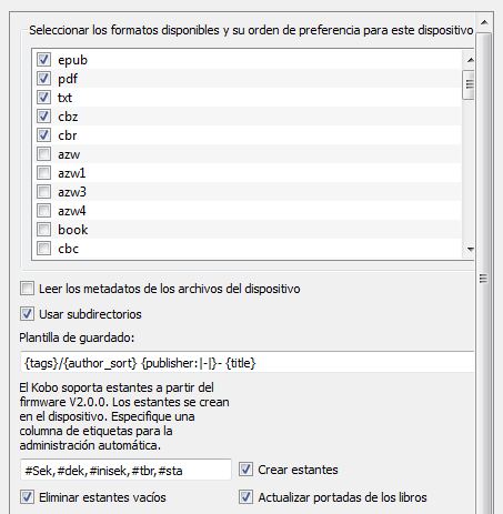

Can I specify tags and series as in tags, series?
Yes, you can do it. As you can see, you can choose more than a column:

Um.... you could just have added Tags to the field in the Kobo driver. My Shelves was just an example!

Peter: I thought it was obvious, but maybe you should change the instructions to say that the shelf field is a list of columns, and that anything can be used. Or at least I can't think of a type that doesn't work.
