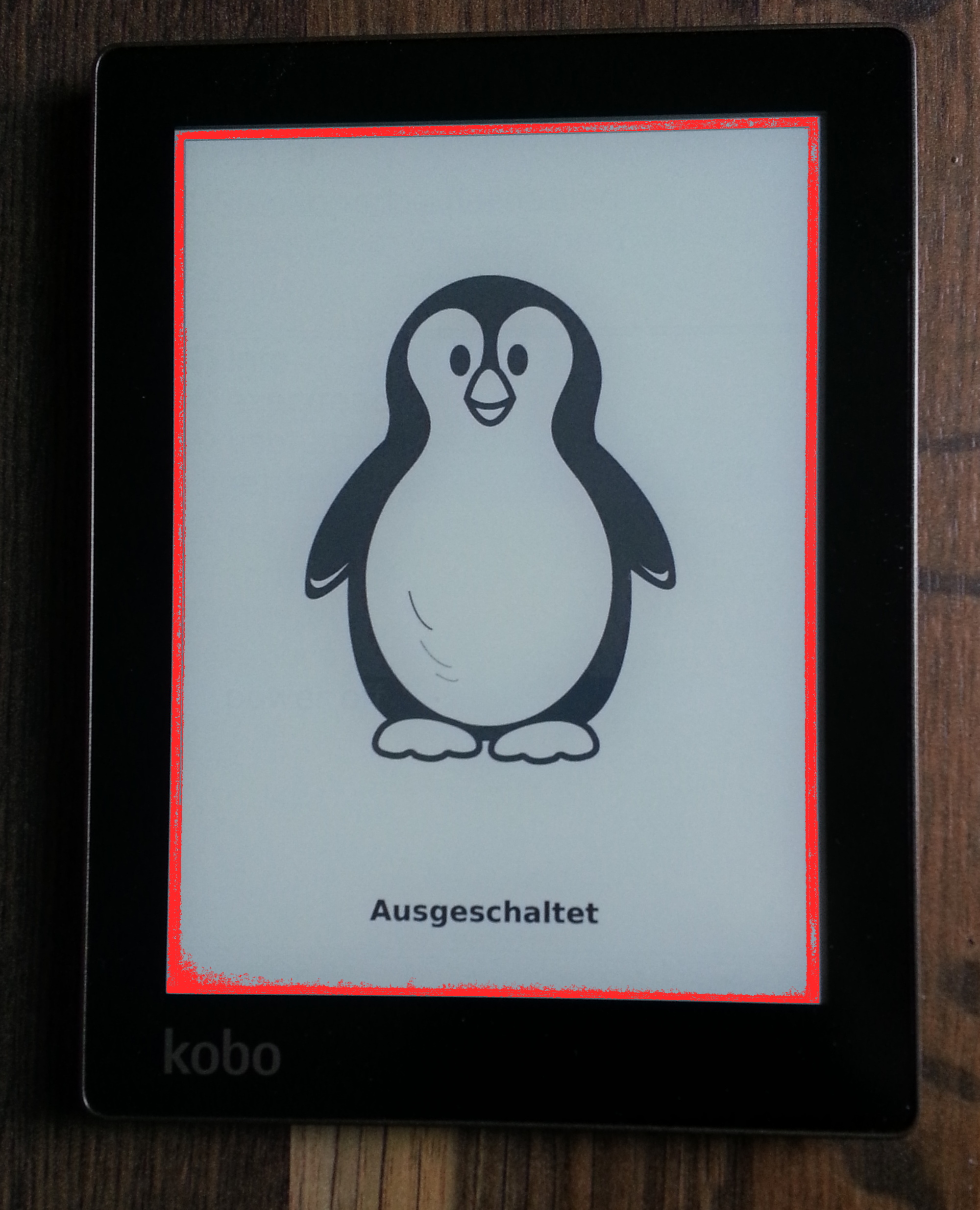

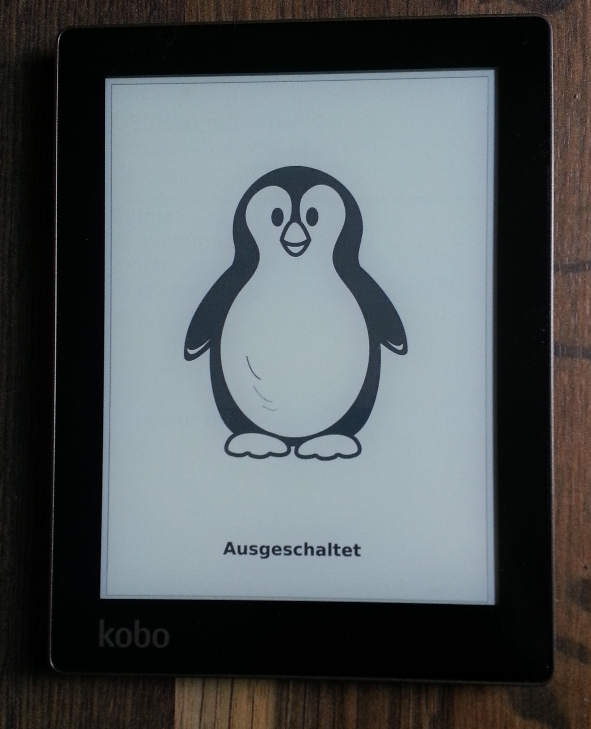

Is it possible to disable the frame around the poweroff message?
Marked in the attachement.
There is a script to find the optimal width, in "tests". with that you can find the settings that will be just small enough to loose the frame.
You can try replacing kbmessage in .kobo/kbmessage by the new one of the uploaded archive. I removed the frame and the scrollbars too.
EDIT: I removed the archive here, and included the content in KBStartMenu_06_update01b.zip, which you can find here.
