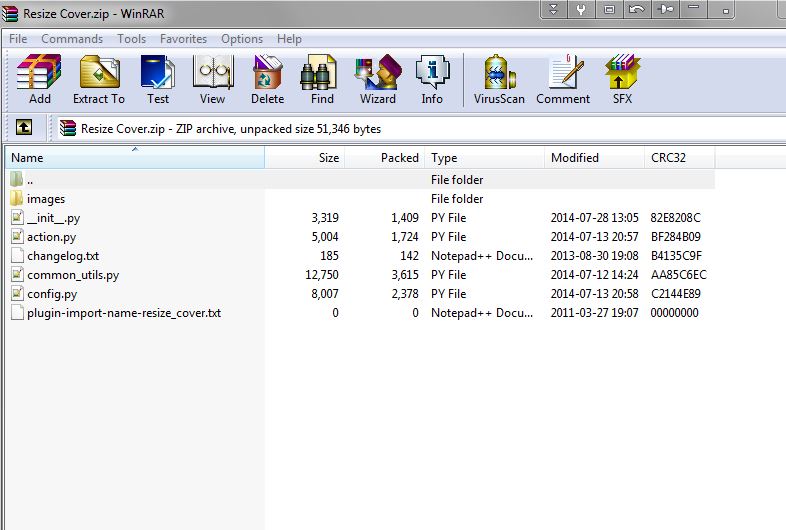

Originally Posted by Mr. Goodbar View Post
I've tried to edit the init file and re-compress, but I'm obviously doing something wrong since I then get an error when trying to install from the zip saying it doesn't have a valid init file.
You need to zip up the files, I suspect you zipped the IOS Reader folder, i.e.
Attachment 131622
I can't seem to get it to zip up correctly, but I think we've found the root issue of the connection issue, now we just need the plugin modified appropriately.
@Mr. Goodbar - the Mac users I know who can produce regular zips use 3rd party programs such as Keka. Everyone else always seem to create them with an outer folder, with liberal sprinkles of __MACOSX and .DS_Store confetti
